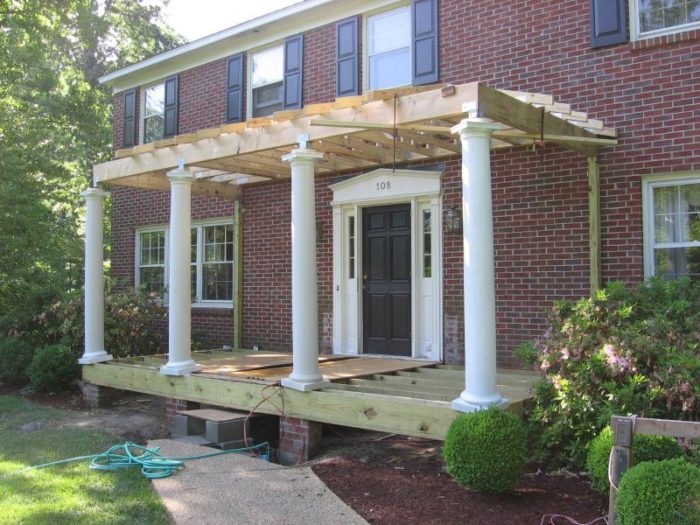

I have looked at that site, have you used any of the T & G product. I would like to know how much it expands with seasonal humidity changes. Some of the sites recommend only using a kiln dried t&g for porch applications 12%. Another that I spoke with said that their air dried, 16 - 19% was ok for t&g. I only have about 200 sq. ft. area. I have attached a photo of progress so far.
