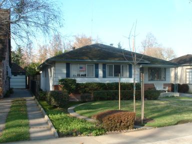

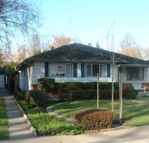

Current  1-story house with 2-ft-deep crawl space will be demo’d and replaced with beefier foundation and new 2-story house in same footprint. Lot is 50 ft wide; there’s a 10-ft-wide driveway, then 35-ft-wide house, then 5 feet empty side yard width, and the setback is 5 feet. I would like to consider a basement instead of just another crawl space, but I got to thinking, is that even possible? I mean, is there enough room to dig for one?
The concrete driveway could be removed in order to build the forms for the basement wall in that location, but what about on the 5-ft side? The neighbor’s concrete driveway goes right up to the property line, and wouldn’t digging for my basement undermine that?  Someone I talked to the other day suggested building the basement out of concrete block, but I’m thinking you still have to dig for that, plus how about access to do the waterproofing?
