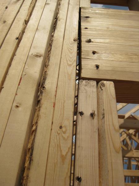

This is a garage door header. Is this okay? Do inspectors check these things? The header and trimmer seem to be pulling out.

Beat it back as best ya can and get the sheathing on there. What's yanking on the other end?

This is on a house being framed down the road from me. I don't know if anything is pulling the other end but there is a floor above it.

How long has that been framed? looks like it's been out in the weather for awhile.
What's piled on top of all those 2by?
Got a pic with a little more of the building?

It has not been out in the weather that long, about 3 weeks when the pics were taken. There are 3 house being framed at the same time, the one with the header pic is the one all the way to the right. Here are a few more pics.
Drive some steel shims under the first pic.
Don't worry about that extra jack hanging a little bit off the foundation. The beam is carrying very little weight because the wall is a gable wall. A single jack would be sufficient.
In img 0411, I'm definitely not happy with the exposed rebar sticking out of the slab. I doesn't look broken either, it just looks like sloppy work.
Put a couple of metal simpson plates on it and it will be ten times stronger than connections that just use nails.
I think they have the house sheathed already.
The sheathing holds it from spreading any more on the outside. The simpson holds it on the inside.
