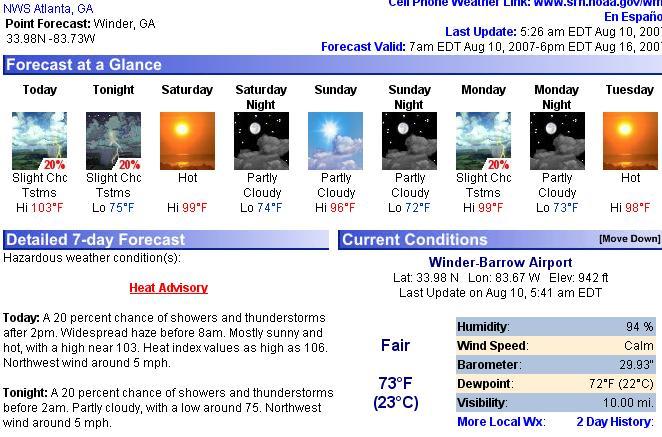

I forgot what size mine is, but its not enough for this weather. 100+ in Ohio. I said to the HVAC guy I want to keep cool on the hottest days last fall, he says mine is large enough. I think it's 2 1/2 tons on a cape cod house. But I still have the 18,000 btu wall unit, so that will frost up the windows (at a high utility cost). That unit comes out when I reside the house though.

If the interior temps are not falling below 80ºF at Midnight then I am not keeping cool, I am not comfortable, and I am constantly calling people. How is this the right choice? :) I understand about short-cycling and the early-wear and lack of proper dehunidifying concerns, but how are these better than what I've described?
I am a Yankee, I like it cooler than most 'southerners' I live amongst. I have traditional Summer time heat sources, and non-traditional heat sources that are NOT being taken into consideration. I've got dang near 1-kW worth of heat-producing electronics in the mini home theater, and another 1.5-kW worth of heat producing computer electronics in another room. AM I suppose to believe these were taken into consideration when the track house was built?
If the interior temp isn't falling below 80 at midnight then your existing system is broken or worn out. Try setting up a water spray on the condenser coil, as fine/light as you can arrange.

SLC,Ut this summer is in 2nd place for the # of days at or above 100= 17 so far. And I am tickled pink with my 16 seer vspd 3 ton ac and vspd furnace. Elec bill just came in for July Aug and its 120$ I Am sooooooo happy with that.

Today's anticipated temp outside will be 102ºF. Last night it was 81ºF on the 2nd floor, but air was blowing out the vents at a slightly lower temp.

Count your blessings: http://www.wunderground.com/cgi-bin/findweather/getForecast?query=needles%2C+ca
