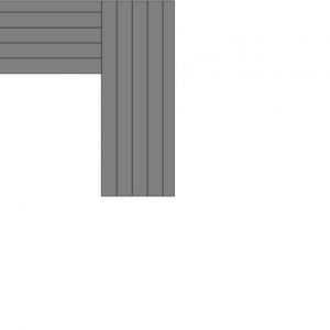

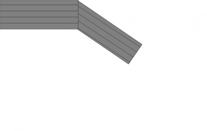

What is the best way to join two pieces of maple butcherblock (27″ wide, 1.5″ thick) where the grain patterns are 90 degrees to each other?  I also have to join a piece that is 45 degrees to the other piece (see attached).
How about either pocket hole screws or biscuits or perhaps some sort of drawbolt?  The seam can show but I need to mate them up evenly with no gap.
Thanks,
Brian
  1. rdesigns | Mar 12, 2009 05:33pm | #1
    See if you can buy some of the drawbolts that are used to join pre-formed formica countertops. You'll need to rout out a T-shaped groove in each side of the joint.
    Biscuits (for strength) teamed up with pocket screws (clamping action) might work, but the clamping action of pocket screws will not be as strong as drawbolts. If you do use pocket screws, make the pocket in the long grain so that the screw threads can grab better in the crossgrain of the mating piece.

  3. Piffin | Mar 12, 2009 06:45pm | #3
    I'd mitre the joints and use drawbolts and epoxy.
