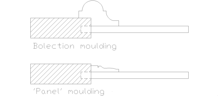

Hope this works...here are a couple of really quick sketches, using a section view of a cabinet door (I left out the rail for clarity)
The bolection moulding has to extend over the surface of the frame (in this example).....it rises over the frame....and is always or almost always rebated…..a panel moulding usually sits below the surface of the frame. When a panel mould gets big enough, it's a shingle mould.<!---->
