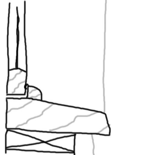

I have awning windows in my basement that open inwards, probably 350 days per year they’re trouble free. They leak like crazy when the rain hits that side of the house, and we’ve had a lot of rain the past 2 months. I added some epdm weatherstripping, that slowed the influx of water, it’s still coming in though. There is quarterround to seal them at the bottom, and the water just runs in to the crack, then in. Maybe some kind of drip edge projecting over the crack would help? Here’s a super rough sketch I did in photoshop.
    MarkH | Feb 11, 2006 04:17am | #1
    I think you do need something like a dripcap for draining the water over the quarter round onto the sill. I'd likely just remove the quarter round and put weatherstrip on the bottom of the window though.  Do you really need that quarter round? I don't think so.

            If it's installed wrong, it's been that way for almost 80 years. I think basements were just for coal when this house was built, so they probably didn't care that much. I can't reverse the windwo, because then it wouldn't have a sill outside, I'd have to rebuild the frame. I'm going to try taking the quarter round off, and use some kind of door weatherstripping on the bottom. The basement is a walkout, so the window is above grade. Thanks for all the responses.

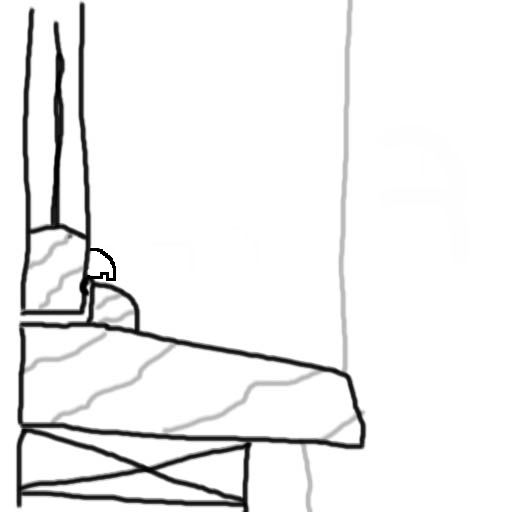

    I added to your drawing to show what I would do. The rain cap piece would have to be very well bonded to the sash, I would gorilla glue it and then bondo the joint if it wasn't invisible, and then put a couple coats of paint on. The drip cap should have a saw kerf out near the edge so that the water doesn't come back around to the window.
    My basement windows are exactly the same inswing awnings, except that they are under big enough overhangs to never get wet. They are also about 90 years old.

      That looks like a simple solution. We have large overhangs too, it's only when the wind blows towards the side of the house. I'll try it on one window and see how it works. Thanks.
