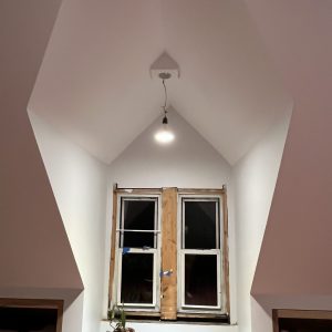

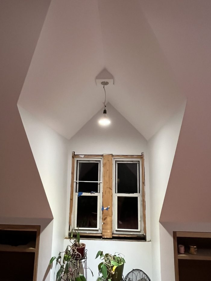

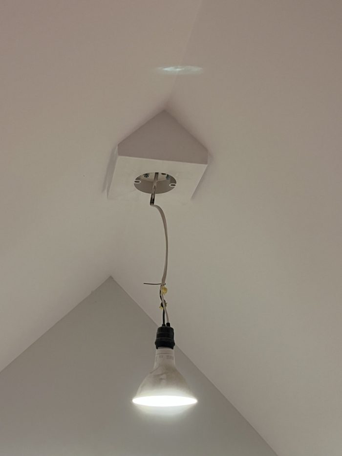

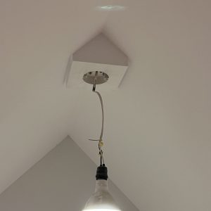

        Don't suppose you took any photos you would share.
          firsttimeroller | May 10, 2025 02:22am | #6
          Why of course! Thanks for your patience. :) Still need to figure out what light to buy though....soon enough...
