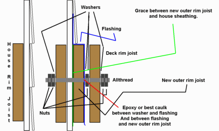

My opinion of the best way to mount a deck rim to the house...
I also think there should be deck support from underneath, near the house, even if you do mount the rim to the house this way...

This has probably been dealt with before, but why the second ledger?
He keeps two sets of books for everything.

That new outer rim joist on the house gives you something more solid to work with. And adding that, and flashing it the way I show gives you the least amount of intrusion into the house. You flash over that, and it pretty much becomes a part of the house. The wall. And the siding system.It also makes it almost impossible for water to penetrate into the house.Then the deck rim itself is held out from there by at least 3/8 to half an inch by stacking washers and nuts in between.If you just stick the deck rim onto the side of the house, no matter how well you flash, you are going to be penetrating the flashing all over the place for your hardware, and you will be trapping moisture right up against the house.

luka-
How come you didn't draw in the washers?

I did.About halfway through I realized they were too small, and decided to just leave them be. Nobodies gonna use my pic as an exact diagram anyway.

Darn, I just finished my deck an hour ago just like you drew it. Now I have to take it all apart to put in the stinking washers.

Are you sure?

Blow it up. You'll see them.=0)
