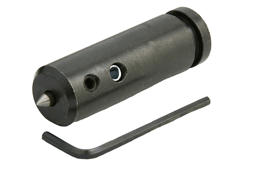

I made this strike locator, but if anyone has a better idea, I’d love to hear.

http://www.majormfg.com/pc-99-16-78-dia-strike-locator.aspx
http://www.majormfg.com/pc-331-16-1-dia-strike-locator.aspxView Image
That looks just like the one I used to use until I went to pre-hung doors. IIRC, the biggest hassle was getting the nail point exactly centered in the dowel. - lol
So, you noticed that I missed by a hair, huh?
Sorry, it's a gift I have (or a curse, maybe) - lol
I think I had a couple of them and both were slightly off. It didn't really make a lot of difference.

Simple and effective. If you have the holesaw for the strike you can drill the door, take the hole saw out of the drill, insert it in the hole chuck end first, push it flush, close door the push it like your tool. Should transfer perfectly.
