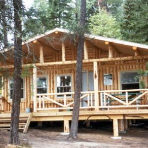

    This is a cabin I built a few years ago for a fly in fishing lodge in nothern ontario. Building these is like a paid vacation, the walleye fishing is pretty good too.

    As long as we are here, tell me about the verticle logs, that is something I have never seen before. Actually, give up all the details, talk it up.

      It's all hand peeled jackpine, there is a groove between the logs where we put a spline to keep weather out. We do it all on site with chain saws and a portable mill to cut the dado's for the splines. We mostly work at fly in resorts so it all has to be very portable to fit in bush planes.
    2. BryanFleury | Feb 05, 2003 03:14am | #4
      The reason for using vertical logs is they are easier to handle than loger ones. Smaller trees can be used (7"-9"diameter),less waste. Vertical or "stockade" construction was used in early settler days so it's not a new idea. The hardest part of this type of work is keeping employees. Went through five last season, its mostly the isolation they can't handle but a little hard work scares some off too.

    Interesting vertical logs.  What happens with the shrink?  How far does the spline go into the log?  My father and I rebuilt and lived in our family cabin, log cabin.

      The llogs are allowed to dry for up to one year ,there is virtually no shrinkage lengthwise. the dado for the spline is one inch deep by 7/8" wide, thespline is 3/4" by 2". This allows for some lateral shrinkage,but it has never been a problem. All joints are caulked with Permachink which stays pliable.

     I think I actually like the vertical look better than horizontal !
     That handrail will not pass code though......... GDR
