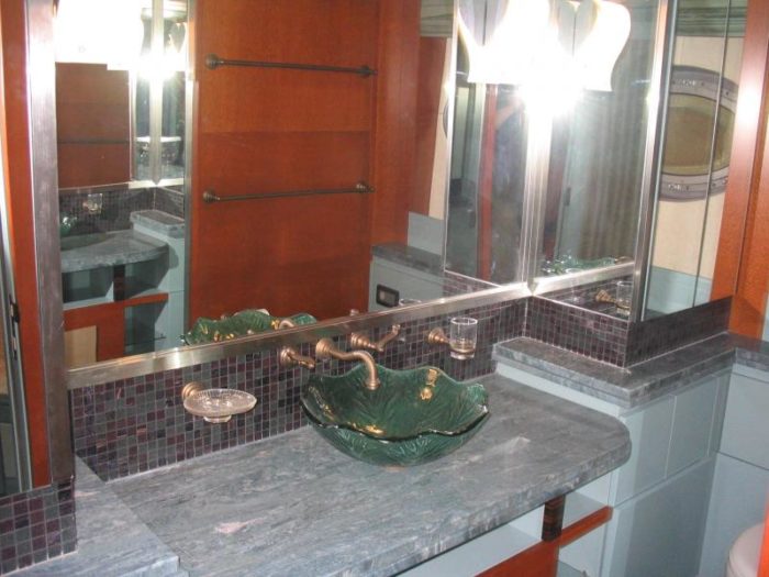

we've been using a product called mystera. Comes in 3/4" thicknesses and is really quite interesting compared to the boring colors of Corian and the knock offs.
http://www.hudsonsolidsurfaces.com/
Here's a yacht with mystera in the galley.
http://www.galatiyachts.com/brochure.asp?&tab=&siteid=&bvdid=11826&modelid=108940&pmid=108940&reflink=&cid=713&
http://www.galatiyachts.com/cgi-bin/onlinebrochure/jsp/photo_gallery.asp?modelid=108940&pageno=1&picpos=11&sspath=&type=P
