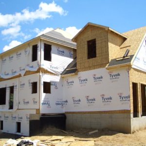

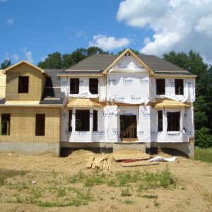

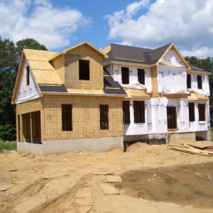

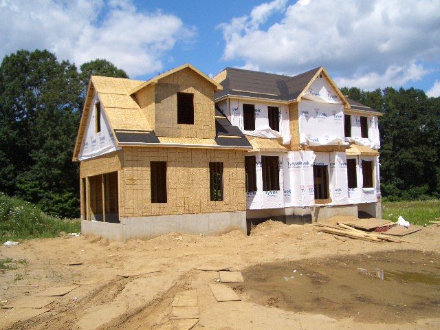

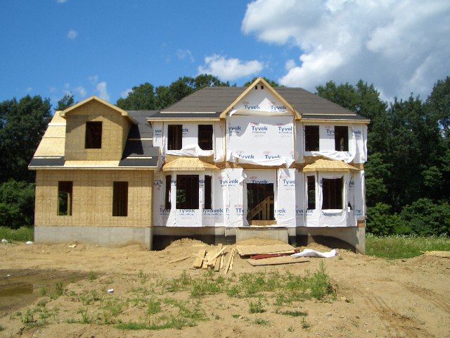

Just finished up this pig Thursday.

    Lookin good hoss.  Just curious... how many man hours would you say?
    1. Stilletto | Jul 23, 2006 11:35pm | #2
      Me and one helper probably had close to 1,000 total into it.
      50 hrs a week x 2 guys = alot of work. What's wrong with me?  I could ask you the exact same thing.

        Yep.... that's alot of work for two dude.  When you gonna buy a forklift dude?  You're the perfect candidate man.View Image
        1. Stilletto | Jul 23, 2006 11:38pm | #4
          When I get the check off this house I probably will pull the trigger.  That guy still has that one I talked about earlier for $5000. What's wrong with me?  I could ask you the exact same thing.

      Looks good.

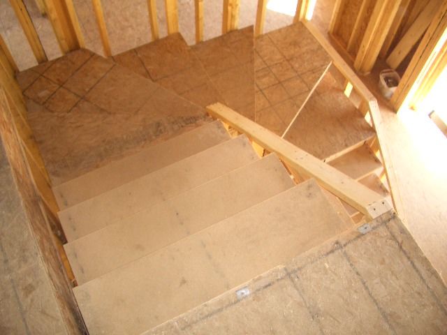

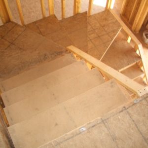

    1. Stilletto | Jul 24, 2006 12:01am | #6
      Thanks man,  the GC is probably going to have to call Armin or Stan for the handrail on the stairs. What's wrong with me?  I could ask you the exact same thing.

        Wonder if he'll get to meet the GF.BTW how many s.f.

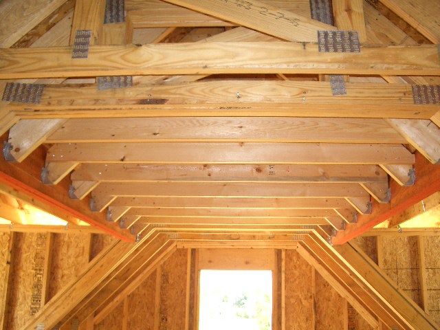

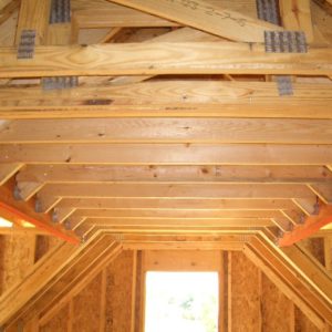

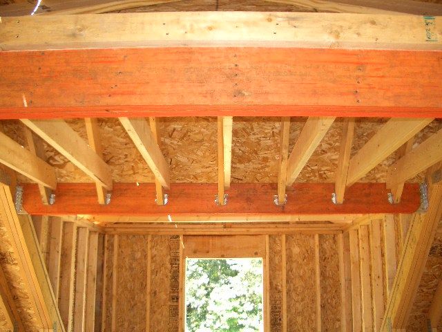

        1. Stilletto | Jul 24, 2006 12:07am | #8
          The house is 2100 sq ft,  without the basement.
          The garage is 970 sq ft,  upstairs and downstairs.  The picture of the room with the 2 LVL beams running parrallel to each other is the bonus room above the garage.

          1. wrudiger | Jul 24, 2006 06:16am | #9
            Anything going above the front door, or is that going to stay a big blank wall?  Seems to be crying out for glass...
          2. Stilletto | Jul 25, 2006 01:46am | #10
            It gets a big window,  two big double hungs side by side then an arched top window to cap it all off.
            I left the sheeting on because I frame the openings after the window shows up.  The outside sheeting gets cut to the RO size.  Then I cut a matching piece for the inside and put blocks in between the two pieces of sheeting.
            The drwallers really like the openings done this way as opposed to a couple of 2x4's nail at 45 degree angles in the RO.What's wrong with me?  I could ask you the exact same thing.

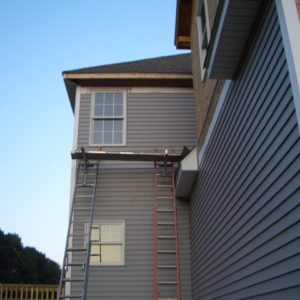

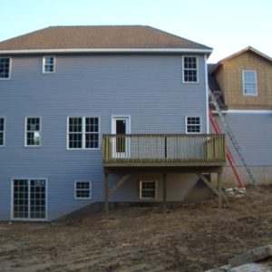

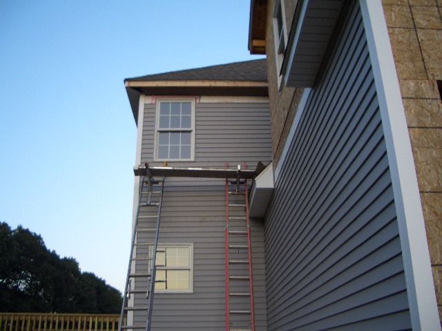

    1. Stilletto | Sep 16, 2006 03:07am | #14
      Update on lot 12,    got the siding started, and the deck built.  90%  of the doors and windows are in.  Waiting on some special order doors.
      What the problem is?
      1. Stilletto | Sep 16, 2006 03:10am | #15
        Forgot the pictures.

        1. TomMGTC | Sep 16, 2006 06:51am | #16
          Is there any wrap or felt going on under that siding?Tom
          Douglasville, GA
          1. Stilletto | Sep 16, 2006 08:49am | #17
            Sure is,  look at the first pictures in the thread.  The whole house has Tyvek on it.
            As for the parts of the garage when I framed it I left the Tyvek off untill the roofers had ran all their flashing.  Then I run the Tyvek and siding over that.
          2. TomMGTC | Sep 16, 2006 02:50pm | #18
            Sorry, I should have gone back and looked at the others. The thing I was curious about was at the cornerboard. How is the wrap detailed there?Tom
            Douglasville, GA
          3. Stilletto | Sep 16, 2006 02:56pm | #19
            The Tyvek is overlapped around the corner.  If the corner is in a trouble area (where a roof dumps into it)  I use the self adhesive window tape on the nail flanges of it as well.
