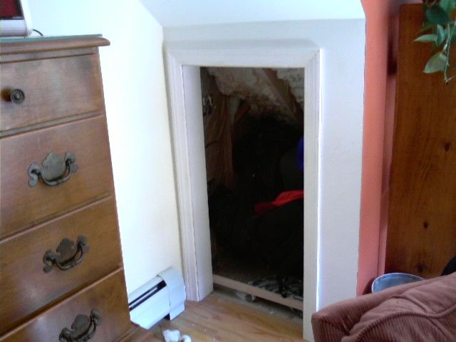

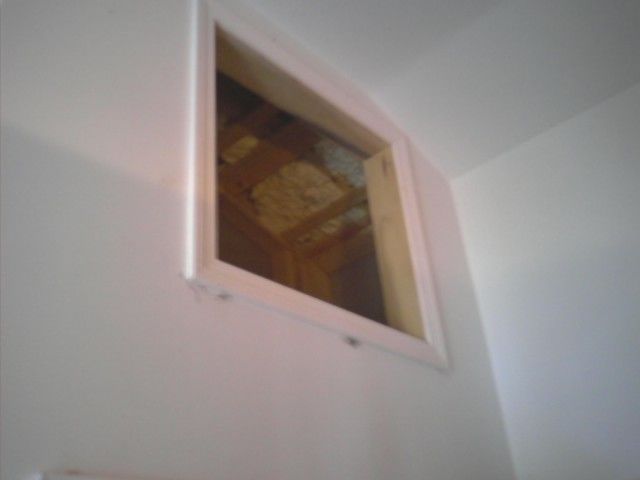

I have some odd size opening I want to put louvered doors in. I have checked bifold doors at the local big box store and nothing really fits my needs. So I am looking for a jig for my plunge router. I know Norm showed how to make one a while back,went to his web site but all I came up with was a video for $39.95+tax.I really don’t want to spend the money if I could find another on the web. I have googled and have really found nothing.
