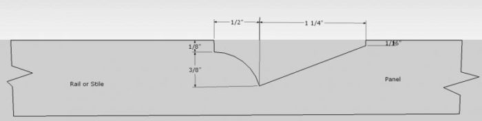

        While we're on the subject, I'd like to use MDF for the panels since they're going to be 20" X 27" and I want to control cost and seasonal movement. How durable is MDF when you bump into it with a chair, etc? In the attached, pic, the center of the panel is raised 1/16" (circled). Is this edge ok?Pete

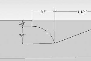

          And here's a picture of the full profile of the panel and the rails/stiles. Pete

          I have some edges similar to the 1/16th that you posted, and have had no problems with them going on 10 years.
