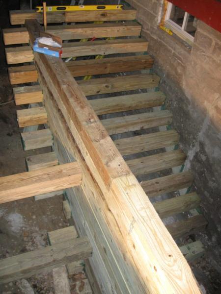

The saw and I got a workout this weekend... finished the logcabin corner, timber stairs:
Wow, that's a lot of lumber in them thar stairs! Looks good!View Image “Good work costs much more than poor imitation or factory product†– Charles GreeneCaliforniaRemodelingContractor.com
Thanks,It should be interesting backfilling under the stairs.

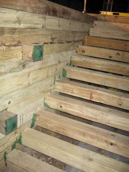

Here are the stairs with the 6x treads housed in a second inverted stringer.Most treads just need to be held up, these also have to hold the earth back, thus the inverted top stringer. I've cut lots of stringers, but this one going over the top, confused the heck out of me... had to draw it out three times.Given the variable dimensions of the 6x, the first cutting was not the best fit. I scribed several of the riser cuts for a better fit... may be a moot point since the 6x's are likely to shrink some and open gaps up (maybe pressure and moisture from the dirt will keep the joints tight).Cheers,Bass
Been following your postings on this project. Bet your happy you picked that saw up! Sure makes life easier when it comes to big timbers. What are you going to do with the void space under the stairs?
The Big Makita has been perfect for this job.I plan to back fill under the stairs with a sand/gravel/soil mix that will drain well. Each tread has a 3-1/2" space that will be filled with rock. As the fill settles I will add more rock.

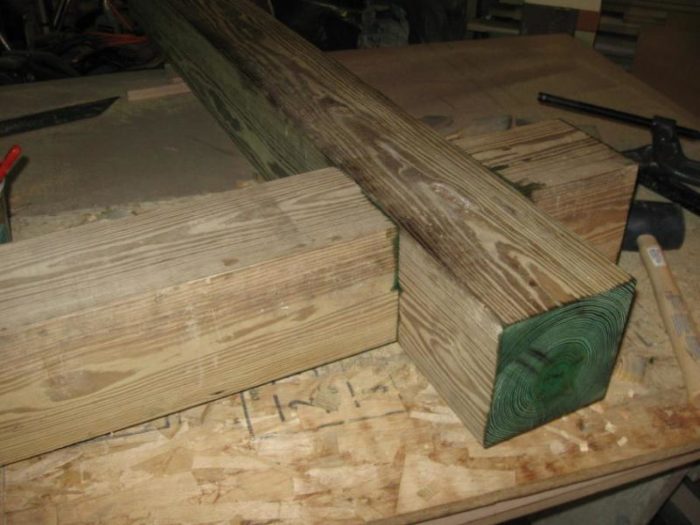

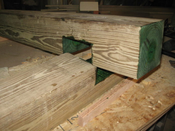

How did you tie your deadmen in? Doesn't look like you used the half-lap joints there.
The deadmen are joined with half-lap joints 2-3/4" deep, integrated into a single course.The notches at the 6x treads are also lapped joints, but with the log cabin configuration, the notches are half as deep (1-3/8"), but they are notched at both the top and bottom and tie into two courses.The log cabin approach, with more, but shallower notches, allows those notches to be cut with a standard 7-1/4" circular saw. For the full and half depth cuts in the 6x, I used the Makita 16" beam saw.The dead men are notched like this:
