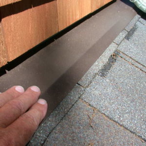

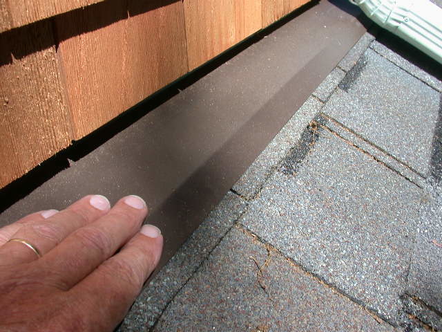

         here's one of our typical flashings ... this one is a breakflash with a hemmed bottom
        Edited 10/7/2005 5:31 pm ET by MikeSmith
          Sphere | Oct 08, 2005 12:35am | #15
          If that still has a cut edge vs. a folded edge, we call that a kick..a hem is where we or Cu actually makes a doubled up edge, with no sharp cut edge.  Spheramid Enterprises Architectural Woodworks
          1. MikeSmith | Oct 08, 2005 12:42am | #17
            that's a hemmed edge.. about a 3/4 hem
            Sphere | Oct 08, 2005 12:54am | #19
            Ok, I see. I was more familiar with Cu's work..3/4 wastes Too much copper..LOL. He can get an eighth or so.
            Just saw his post..ok. we are all correct.
