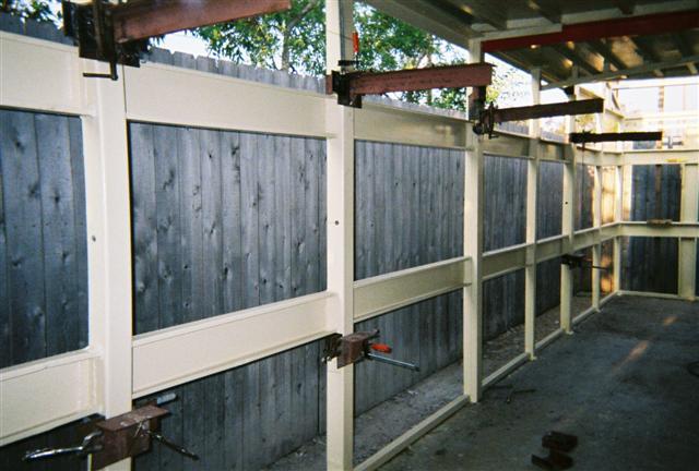

Auto darking helmets will spoil you... ;>) Most of the new ones run on the light from the welder instead of batteries. The higher costing ones have a selection knob to go between 3 different darkness levels. It is much quicker to use one, especially when tack welding loose parts at odd angles or in tight quarters...no fuddling with the helmet... I built a lumber storage room with removeable shelving, so I was welding with both 2x2" tubing as well as 1/4" thick 4x4" wall thicknesses. and 1/2" thick steel plate. The only thing I had to worry with was changing amperages....

Wow, that's an impressive project. I would be interested to hear what you do with all that drying. What kind of wood and your source for it etc..
