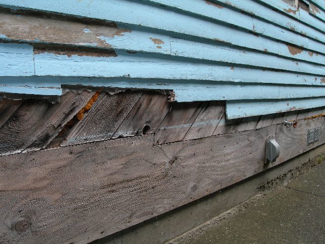

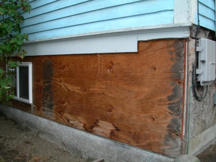

Below are five pics of fossil's place in question.
This post will contain the larger sized pics for clarity in DSL and the following post will be resized for dialups.

Now I understand your problem.Yes, prepaint of buy it preprimered.Sounds like to do it 100% right, you will need to remove the rest of the siding. But since it has survived this long...
Around here, that's called diagonal sheathing. You would cover it with 15 lb. felt & then apply siding of your choice...
You can, of course, insulate first. I think you need to consult Mike Smith!
I realize that is what I'm supposed to do, but it seems pointless if the rest of the siding on the house has nothing but diagonal sheathing underneath with no vapor barrier or felt.Essentially felting one area where there is no siding on the lower portion of the home. What about all the water that might infultrate from above, running behind this one felted area?Is my best bet to prime both sides of the ceder siding and caulk butt joints that hit window trim?I apologize about my poor terminology.
