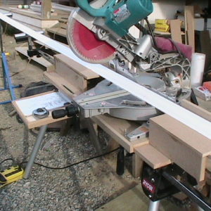

Thought I’d up grade my mitre saw stand.
And yes it is a Ryobi. I was shocked too, but impressed – very solid!
I have the Same saw stand. Not with the fancy set up like you have built, but the Ryobi is very nice. It's the same stand as the Rosseau, with out the awful saw attachment. I like that you can remove the saw easily without sliding it on or off. The saw attaches in the same was as the dewalt stand.
never thought I'd buy anything with name Ryobi on it. But my partner has the same stand and after using it and looking at some higher priced brands, I couldt see why not to buy it.
I made the upgrade because I have been used to sight built tables that have continuous support. which I like, but they are not very portable. The portable stands have dead zones where you can't make repeat cuts ( anywhere close to the saw.) also sometimes your stock flops around with lack of continuos support. one is able to slide the supports back and forth which works but kind of anoying. also one can get additional supports to add on. But I thought I'd add some extra support of my own.
I threw this one together with MDF I had on hand as a sort of a prototype. Down the road I'll see what I can improve and use some nice stock.

nice set up.
I took a look at a buddies ryobi and up graded too ...
... bought the DeWalt so I wouldn't have to build one that worked!

I've had the same stand for a year and a half and am still impressed with it. A few well placed stickers from my favorite ski area helps take the sting off owning something ryobi.
yeah....I had to wear sunglasses and wear my hat down low when I walked out of the store with a big Ryobi box. especially since I'm always telling people not to buy Ryobi! View Image View Image
I just did something very similar. Mine is just two boxes with drawers. I got two sets of the DeWalt mounting brackets and built the drawer boxes to match the saw table height. I use a strip of scrap and a clamp to make a stop that can work in those "dead spaces"
For long stock, I can use the extending support arms, or roller stands. So far, I like it fine.

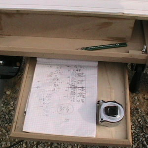

love the drawers!
yeah, without a fence to clamp to, you are stuck with the dead zones.
I realy like what you have done. I kinda threw mine together, but I wanted someplace to put a pad and pencils. dunno why, but I seem to have a problem with the pencil not getting to my pouch when I'm working at the stand, so they seem to end up on the ground all the time.
Edited 7/2/2007 7:57 pm by alrightythen
The drawers were sort of an afterthought. I was fooling around with some pieces of MDF mocking up the boxes when I realized that I would have two perfect places for drawers - and drawers are always a good thing. - lol
I'll probably make some dividers for one of them so the pencils don't wind up in the back all the time.
Not surprising both setups are using an LS1031. We agree on the best slide saw.
You know, the crew I used to work with had two of the LS 1013's
when I went out on my own and needed to get my own slider, I looked to buy something different. But after looking at them all, I ended up choosing....you guessed it. View Image View Image

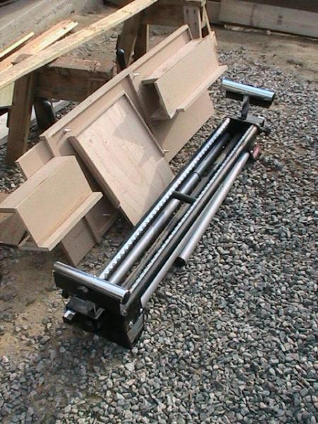

from this.......
the upgrade was not in the stand but in the shelf add on. Although I guess buying the stand was an up grade as well.
