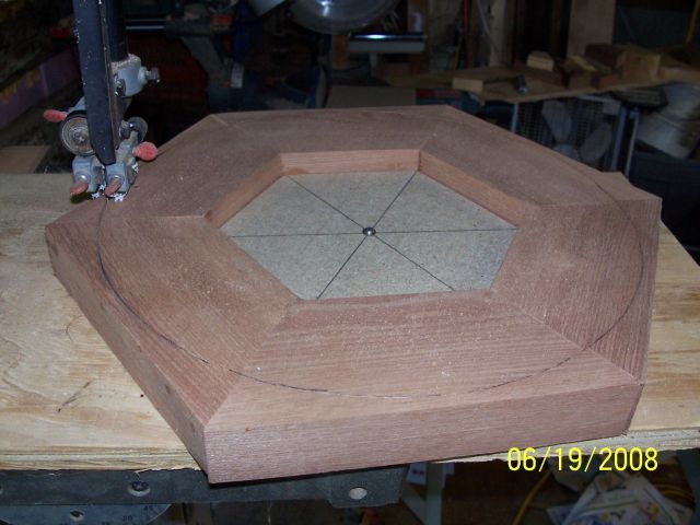

Basswood was showing his columns so I thought I’d show new base elements being made.  These are for an existing 100+ yr. old house.

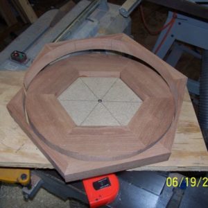

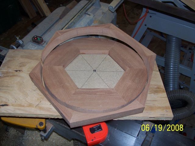

Normally I use a octogan, but I felt like a hexagon this time..here is a blank being circled out with a pivot plug on the bandsaw
I penciled in the cut line so y’all can see it.

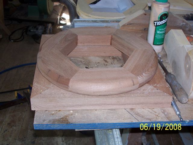

Freed from the blank, I am glad I kept the biscuts way back on the miters..BTDT with them showing

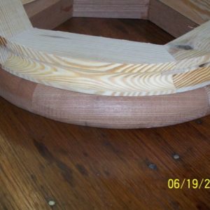

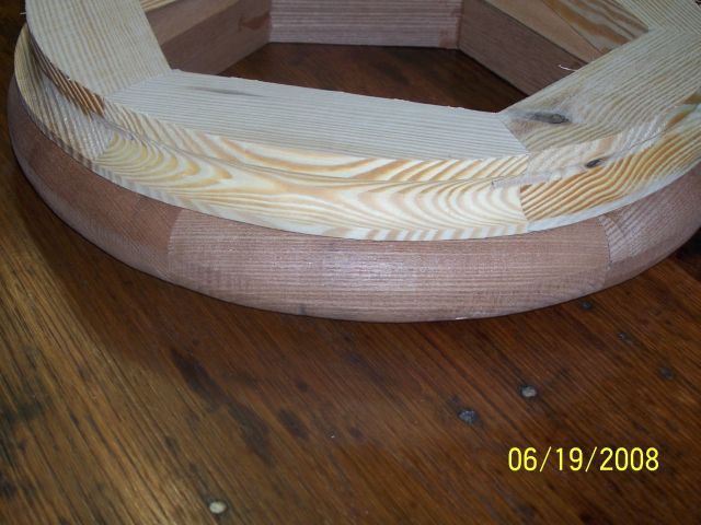

I used Kentucky Coffee tree for these parts and SYP for the next ring that has a cove, the KY tree is pretty rot resistant, and the SYP is sappy as well, after an epoxy coat and paint, they should out live me..here are the two stacked awaiting finish sanding, couldn’t help exposing the biscuits here, but the epoxy will reinforce the join.
The two rings sit on the square bases, and they inturn will sit on some Azek feet to allow air flow and raise the wood off the marble plinth block on site ( the one I had to reset and killed my back, 20×20,20 ” cube)

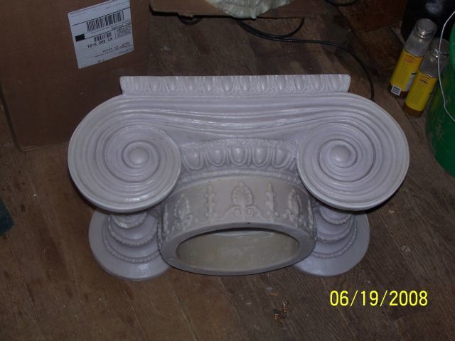

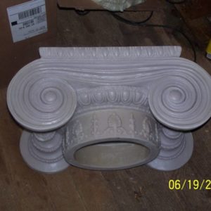

The column it self was stripped and re-staved with TB3 glue, and is outside with the new primer drying, these are what the brandy new capitals look like, one of the existing was shot to hell and back, so I am replacing both so they match exactly ( Change order! Ka-ching!) not really expensive considering..it was about 800 for the pair.
The necking on the new caps are shorter than the old, so I have to make up an 1.5″ in a few places..add a 1/4 here, add an 1/8th there..I still have to round out the abacus tonite and prime it all, then install.

  3. Henley | Jun 20, 2008 01:06am | #5
    I like the pivot plug.
    I've always centered a piece on the bottom face.
    Seams like less fussing around your way.
      Sphere | Jun 20, 2008 01:20am | #7
      It's simple. I'm going back to octagons next time, getting that 30 degree dialed in was a PITA on the Bosch slider, at least 22.5 has a detent, but a 1/4 degree off 8 (16) times is worse than 1/4 degree off six times( 12 actually).
      Some might wonder why the segments, the old original parts all split and endgrain exploded from weather and age, making the segs. makes for a longer lasting part.  I have inspected some I did next door to this house, about 3 yrs ago, and VERY slight opening of the miters, and IIRC I used PL premium there. This is TB3 and I will epoxy coat all ( like a boat lay up) and then prime. I expect that to be a better method.
      The TB3 seems to absorb in the end grain a lot more than most poly glues, and I really don't care for Gorrilla, or Elmers Nano, but the PL brand of liquid poly is pretty good stuff, less foaming.
      I like to experiment with all the glues, and some jobs I may use 3 different adhesives in different locations for specific situations. Judging by the scraps and how well the joints hold, I imagine with the biscuits and TB3 ( poly won't swell biscuits) it'll be stout. The square bases are pocket screwed and PL liquid glue.Spheramid Enterprises Architectural Woodworks

    Nice work.  The pivot sure makes cutting the circles easy.  What is a "Kencucky Coffee Tree?"  Looks kinda like Gum Bumelia that we have down here.
      Sphere | Jun 20, 2008 01:23am | #8
      It's similar to Ash and Elm as far as I know, stringy, doesn't split easily. Ring porous. Glues and finishes well, stable with humid swings.
      David Doud sawed this particular hunk, I have more that was sawn last yr. setting in a barn drying. My wood of choice for my trim at home and furniture for our kitchen.Spheramid Enterprises Architectural Woodworks

        How many passes for the Round over?
          Sphere | Jun 20, 2008 02:39am | #10
          Basically one, I dive in and cut reliefs for the blowout areas and then whack away at the islands left, the bit never gets changed from finish height..( hack)  LOL. That's a 3/4" Rad. Roundover.
          All the chatter will sand out.Spheramid Enterprises Architectural Woodworks
