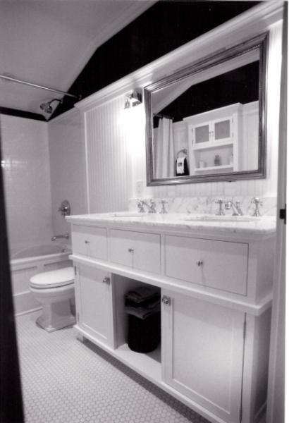

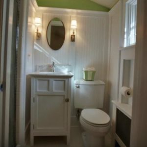

          1. Lateapex911 | Dec 28, 2005 09:24am | #19
            I have decided to use MDF next to MDF whenever possible, although I seem to go against Gary's suggestion, LOL.
            I have used lots of the beaded and the pain. I am just finishing a master bath suite with  it..I'll post pics soon. Heres a beaded use or two. AS you can see, I go higher than you guys are talking about, LOL.

          2. KeylessChuck | Dec 30, 2005 06:48am | #21
            Nice work. I don't even think the ceiling in my bathroom is that high!
