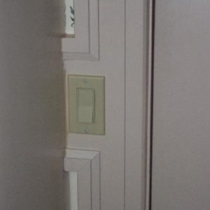

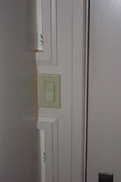

    1. calvin | Nov 22, 2006 03:46am | #11
      This was a case of 10 lbs. of #### in an 8 lb. bag.  No moving the box so the feature was done.
       View ImageA great place for Information, Comraderie, and a sucker punch.

        jhausch | Nov 22, 2006 03:57am | #12
        And there you have it!
        Nice work.

        1. calvin | Nov 22, 2006 04:03am | #13
          Thanks man.  You do what you have to do and hope it doesn't offend someone.
