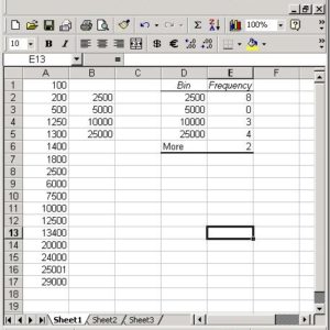

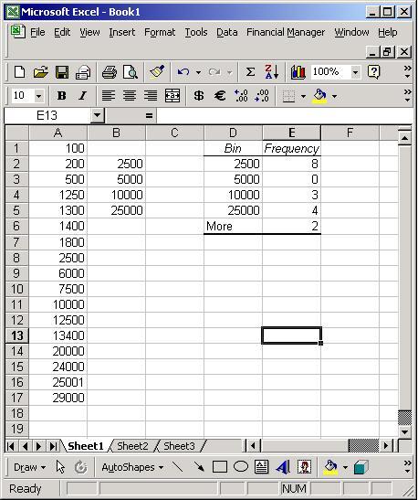

      2. EWong | Jan 29, 2006 07:16pm | #9
        Somone already pointed out - the COUNTIF function.As pointed out - computers are finicky - "Basement" is NOT the same as "basement"Now the NEAT thing is you cna use the SUMIF function with a criteria set to a differnt column - in other words you could sum up all the "basement" work done.Now if you DONT KNOW how many types of descriptors you have used - ACCESS is a bit easier to use becuase it can pull a report breaking out each descriptor seperately.In the sample I also coded the critera in the column to the left. This allows easy cut and past of the formulas.
        Edited 1/29/2006 11:19 am ET by EWong
        File format
        1. EWong | Jan 29, 2006 07:21pm | #10
          opps - cant edit by adding an attachment.../
          File format

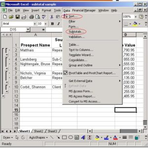

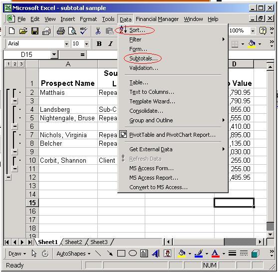

          1. JMadson | Jan 31, 2006 12:12am | #29
            First Sort by Job Type. The sort function is under Data. (see the jpeg attached)
            After it's sorted, run the Subtotal function, also under Data. It's very easy and does exactly what you need without any formulas
            Joe
            File format

          15. LorinBoyer | Jan 31, 2006 07:45am | #33
            After you figure out the basic formulas to count and sum, you will want to look into something called a "Pivot Table". It will do everything you need. The way you are inputting the data in your "Example.xls" spreadsheet is perfect for a pivot table. However, let me warn you that the pivot table is an advanced feature of Excel and can take some time to wrap your brain around the concepts it is based on.
            I put together a quick spreadsheet that demonstates the basic formulas talked about in this thread and a Pivot Table example.
            File format
          16. CAGIV | Jan 31, 2006 09:57am | #35
            A friend of mine had me trying to trying to create pivot tables for this the other night, I gave up on it until I either dig out one of my old books on Excel or purchase a new one, but they do look very useful
          17. LorinBoyer | Jan 31, 2006 06:51pm | #36
            Pivot tables are difficult to understand the first time through. I think your spreadsheet looks good. However, you will find that updating it or making changes to it will be a real pain in the future. Just imagine adding one more Job Type or adding one more column of information to analize (it would take a while). You may be better off keeping all the data in one big long list and using Autofilter and Pivot Tables. Spend the couple of hours learning about those features and it will save you a tremendous amount of time in the future. I'll post an example below. When I created the spreadsheet below, I recorded in a flash video some of my actions (I didn't edit the videos so they might be a little rough). You can view those videos here:
            http://www.maderasoft.com/LeadTracker/CreateDropDownLists.htm
            http://www.maderasoft.com/LeadTracker/CreatePivotTable.htmEdited 1/31/2006 10:54 am ET by LorinBoyer

  2. rvillaume2 | Jan 29, 2006 03:56pm | #4
    Cut and pasted this from excel help. I think this is exactly what you're looking for. I've used this and it works well. When you get the results you can then graph it if needed, or do anything else with it you'd like.
    Calculates how often values occur within a range of values, and then returns a vertical array of numbers. For example, use FREQUENCY to count the number of test scores that fall within ranges of scores. Because FREQUENCY returns an array, it must be entered as an array formula.
    Syntax
    FREQUENCY(data_array,bins_array)
    Data_array is an array of or reference to a set of values for which you want to count frequencies. If data_array contains no values, FREQUENCY returns an array of zeros.
    Bins_array is an array of or reference to intervals into which you want to group the values in data_array. If bins_array contains no values, FREQUENCY returns the number of elements in data_array.

  6. JMadson | Jan 30, 2006 03:09am | #15
    CAGIV,
    Your question can be answered by using the formulas in the other posts. Or you can you use the "Histogram" function already built in to Excel. It does exactly what your looking for. Click on Tools in the top menu and then Data Analysis and then select Histogram.
    One column is your data, numbers, values, etc. The next column is your break points. In your example it would be 2500, 5000, 10000, and 25000. That's it. (see the jpeg attached for an example)
    Look up "Histogram" in the help menu. You may not have it installed if you chose to use the "Standard Installation" when you installed Excel but it can always be added if you have your disks.
    If you get used to it, it's the easiest thing to use - no formulas needed.
