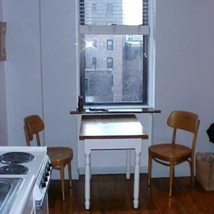

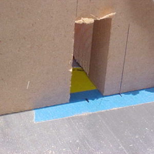

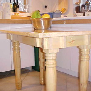

Moving to Manhattan soon (as long as the interview with the co-op board is successful) and my current kitchen table is too big, so I decided to make a new one.

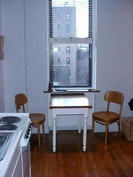

The first pic is the table that the girl has there right now, an inspiration as far as size.

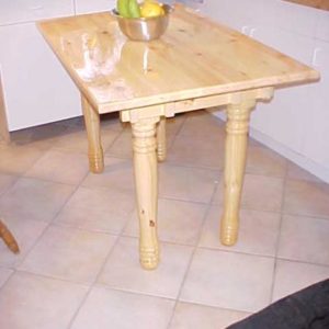

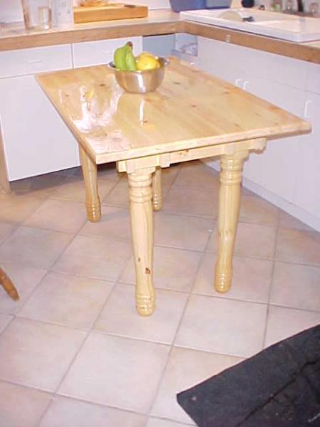

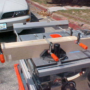

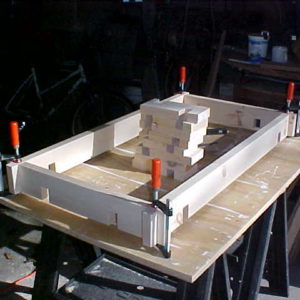

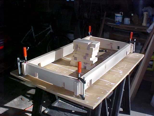

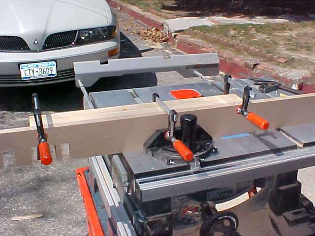

I wanted the legs to be removable, so I came up with an apron design that allows the legs to slip in and out. I cut half lap joints out of 5/4″ x 4″ pine.

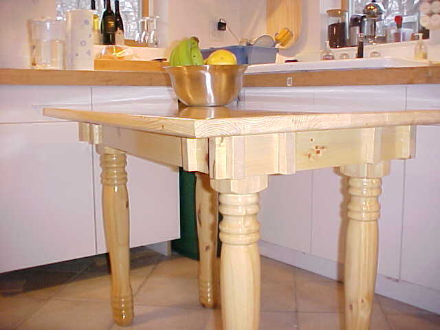

The table top was made out of three prefab pine stair treads. I cut the bullnose off, ripped them to 10″ each, and glued them up using a bunch of biscuits for alignment. My tools are limited, so it’s not perfectly flat, but I’m happy enough with it.
Marine Engineer
  1. JoanM | Apr 09, 2005 03:36am | #1
    Well, I think you did a fine job... thanks for posting the pics... what is the finish??  is it gloss varathane??
      MarineEngineer | Apr 09, 2005 08:54am | #3
      the finish is Benjamin Moores "Stay Clear" acrylic polyurethane. It's a water based finish. I did 8 coats on the top, sanding with 320 grit paper inbetween. 4 coats on everything else.Marine Engineer

  3. Shoeman | Apr 09, 2005 04:57pm | #6
    Looks good.
    Looks like you spent a little time getting that top to shine like that.
    Your shop looks very similar to mine.  Great ventilation.

    intrepidcat | Apr 11, 2005 11:06pm | #11
    Looks great. Good work. Hope you enjoy your new place.
