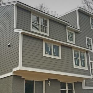

        This is what I mean with the trim. On your house, this type of trim would reduce the big spaces you have now with the vinyl. The window trim has a rabbet all around for the siding to fit into so the ugly vinyl trim isn't needed.
        1. SteveShiposh | Jun 09, 2022 05:06am | #7
          Got it! I also googled and found these. I showed them to the new siding contractor we found and he said these would be easy adds in addition to the new windows and redoing the siding. Expensive, but we’ve spent so much on the inside remodel, it’s would make sense to leave the exterior looking the the crap it looks like now. Thanks again!

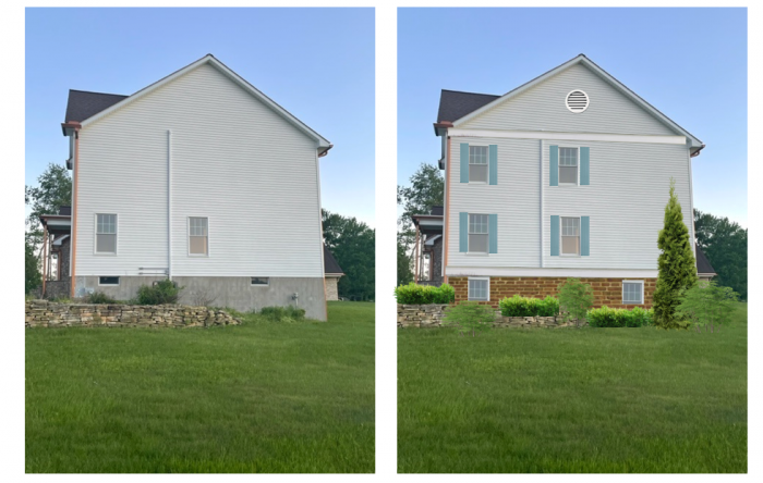

    My wife came up with this “after” design. Thanks everyone for the advice. It really irritates me that the siding was installed incorrectly and the contractor won’t own up to it, but we have a great siding contractor now and with redoing the side, we can make it less bland (though the amount of the check I need to write for this will hurt)
