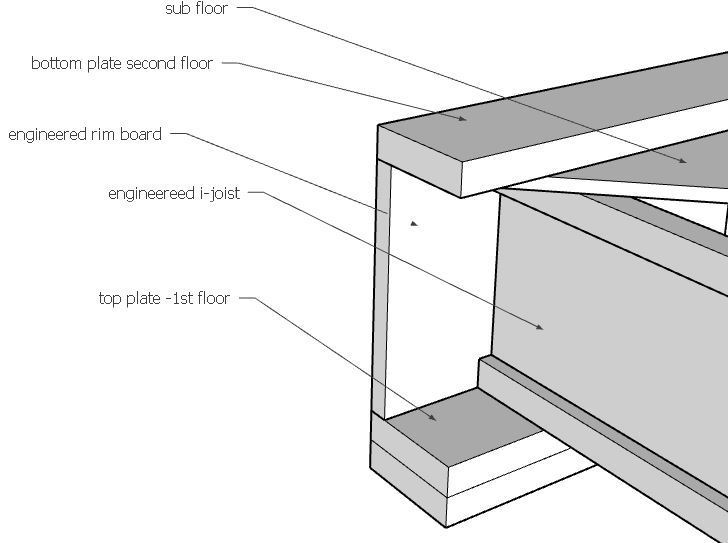

Hello All,  I am looking for answer which I can not seem to find elsewhere.
How is the second floor bottom  Plate secured to the OSB RImboard and engineered I-Joist which has a 2 x 3 flange
Nail vs. Screw.  Size and length. Quantity?
Thanks,
Jim

    2. john7g | Aug 04, 2018 10:35am | #4
      Take your drawing a few steps further and put the sheathing on it.  The sheathing is supposed to overlap the plates to tie it all together.
