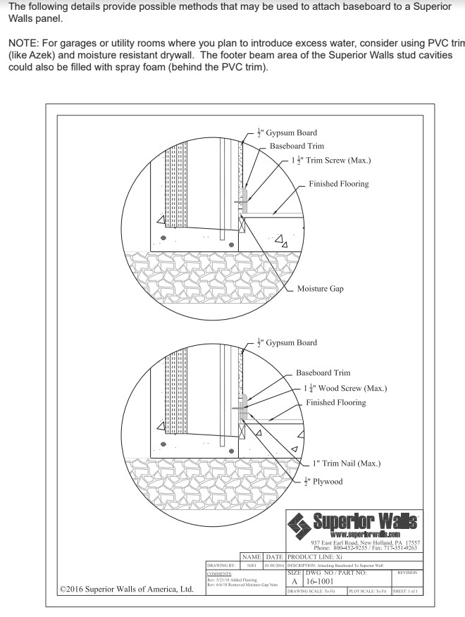

I’m finishing my basement right now and I’m trying to plan out my drywall strategy with my basement wall configuration. My house has the original R-5 Superior Wall Systems that uses 7.5″ x 3″ concrete studs with an exterior concrete sheet. The “top plate” and “sole plate” are also concrete. One problem I have is that the sole plate is about 3″ below the level of the floor, effectively leaving no place to nail the bottom of the drywall. Similarly, the sill plate doesn’t extend all the way to the interior surface so there is a 1.5″ gap at the top of my top plate where I can’t nail the top of the drywall. My original plan was to install blocking between the studs at the bottom of the wall and add blocking to extend the sill plate and give me something to nail into at the top. I contacted the manufacturer of the wall system and they said I shouldn’t bother with the blocking at the bottom and even to leave a drainage gap below the drywall and then put a baseboard over it. That DOES sound a bunch easier. I plan to use construction adhesive in addition to screws to mount my 1/2″ drywall but I feel if I don’t attach it at the top and sole plates, I’ll end up with a wavy mess. Not to mention an susceptible bottom edge, even with the baseboard. What do you think?

    The company specs leaving a moisture gap between the floor and drywall and bottom and give the option of filling that with plywood. This is to keep the Base molding from kicking in underneath into the gap.

    Go with a couple inches of half inch plywood at the bottom, and cover the joint with trim. If you want to, you could get some treated 2x8 and use some polyurethane adhesive to place short lengths vertically in the bottom of the well between the studs.

      Flooring will be thick carpet, insulation will be 6.5" unfaced fiberglass batt. There is a 3" x 3/4" PT grade board on the inside of the well that I've screwed some PT blocking to. That seems to work pretty well but it's a bit of a pain in the neck and an added cost. I'd sure like to do 1/2" drywall. If nothing else it would mean I wouldn't have to take my outlet boxes back. :-D

    It's settled. 1/2" with PT blocking at the bottom. Now, does it need to be mold and moisture resistant? I'm having trouble finding the sheet dimensions I need. My ceilings are a nice round number of 8' 7". I intend to do a 54" panel under a 48" panel with a 1" gap at the bottom. I can't find 54" in moisture resistant though.
