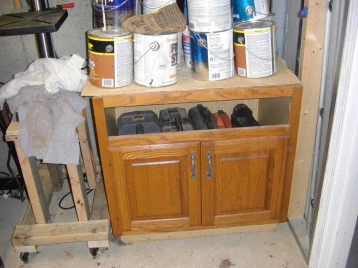

Greatest of thanks to those who helped, the cabs are in place and were the best non-investment I have done ;) pics will come soon enough

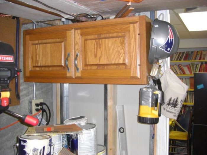

here's how it went down. I sistered the wood studs with the metal studs w/ screws then installed bracing from the wood stud to the joists. then simply installed the cabs. because these were bathroom vanity cabs, they have a false front, so I am building some new drawers for them
