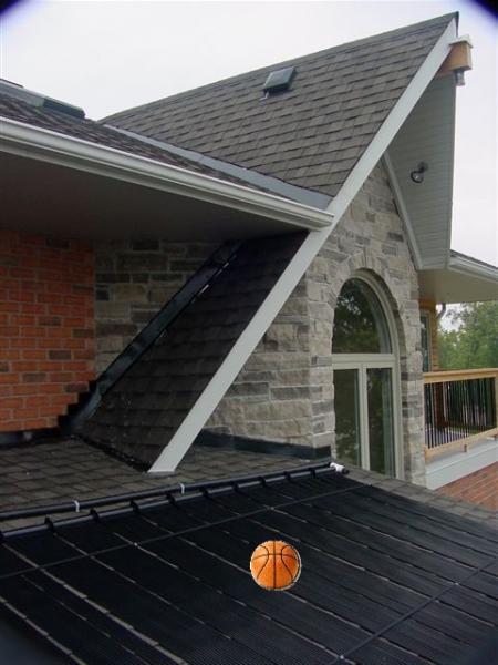

Here's the picture. The basketball shows the approximate location of the leak (before the solar panels were there). NONE of the roofs above it drain onto the low-sloped roof, in fact the roof above protects the top 4' to 5' from a vertical rain. It's not clear in the picture but the part of the steeply angled roof that is below the upper roof actually slants back and under it, (it's a prow roof) so no water hits this smaller lower part at all during a vertical or even slanted rain. The valley drains into the eaves trough (what some call a "gutter"). It is important that I add that the roof leaked first during a light rain, meaning the water did not come shooting down the valley and over the trough onto the lower roof. In looking at this situation more closely now it looks like the valley between the two different opposing slopes cannot be responsible for the leak, as no rain could even have touched the steep part above it (because it is sheltered) during the leaking.
Yes, the diagonal line could have stopped at the upper roof and not continued to the the lower roof, but this would have given an inappropriate formal appearance to the house.(And it remains to be determined if this detail is the cause of the leak - being sheltered, I feel it unlikely.)

Sorry, dude. That roof is a classic candidate for hot tar and gravel.
If you don't want it to look that way, you can build a fake roof on top of that and shingle it for looks, but it's a PITA and a waste of money. Who the heck can see the surface of a roof that shallow from the ground? Wilt Chamberlain at the top of a slam dunk? And it doesn't look like somebody staring out that window in the stone-faced tower or whatever it is will see much of the roof either. If they do, they won't see it in conflict with anything else, so what's the problem?
Maybe the ice & water membrane would have worked, if it had been/was installed/installed correctly. But there's old technology that'll solve that problem if you can find a good installer to do it. Why re-invent the wheel?
Dinosaur
Dino - I don't disagree that the roof isn't visible from the ground. Appearance wasn't a problem, but it's a little late now to change.... maybe. (?)
- Brian.

I can't imagine any scenario when putting shingles on the flat roof pictured would have been appropriate.
Additionally---when the gutter on the upper roof gets clogged( they DO clog frequently yoU know!) all of the overrflow is gonna cascade down on to the lower roof.
Also, I would check out the intersection of the rake trim and the flat roof---almost directly in line with the area marked as the assumed site of the leak. I would also like to know if the upper piece of rake trim overlaps the lower piece of trim,or if it is run behind it as is very commonly done( helps hide the seam visibly from below. this can easily cause a leak---again at the rake/roof intersection----EVEN if that intersection is caulked----as the caulk is simply trapping the water behind the trim.
But heck,Dinosaur---wadda WE know? LOL!
Me, neither. As soon as I saw that picture my instant reaction was, why da F didn't somebody tell this guy about gravel...?
A gazillion brownstone and tenement roofs in NYC can't be wrong, ya know?
Dinosaur
Fully adhered seamless EPDM would have worked perfectly for this application. The aesthetical argument goes out the window by using that ugly black solar panel you have installed. I'm amazed you rejected the proper material being used based on appearance! Didn't you consider the appearance of the solar panels?

Well gentlemen- It's been a long few days. Here are closeups of the edge of the prow, the valley of the upper roof where it meets the lower eaves trough, and the area where the prow fascia meets the lower roof. They do look reasonably sound (at least in a light rain) to me.
I have to remove a section of soffit for access to confirm that some work that the roofer has done since has solved the leakage problem.
A conflicting observation- After years of exposure shingles under a solar panel such as this one have ended up looking like new ones compared to uncovered ones next to them in this locale using similar panels. Slits every 4" or so, plus the wrinkling from expansion prevents contact with the roof intimate enough to cause moisture trapping. This is one ineffective vapour barrier.
Regards - Brian.
ps. Dino - je ne sais pas. K's P gasket???
Thanks for the photo. That puts things in a whole different light.
If you had called me to repair your leak, the FIRST thing I would suspect, regardless of the material used on the low pitched roof, is the detailing at the valleys and roof edge that I have indicated in the return photo.
I see no drip edge on the fascia to prevent water from bleeding back. That is critical in a place like I have outlined in purple where a high volumn of water from the upper valley can follow that edge.
I cannot see how the bottom of the cvalley is trimmed out. I either hang over the drip edge by an inch or two, or more commonly, I seal and hem it back onto the drip edge. You could have water from bottom of that upper valley wicking under the vally and down the back side of the fascia until it hits the lower roof where it gains entry.
and again, the base of that fascia must be carefully detailed with flashing, none of which is apparant in the photo. All that shows is a tightly caulked fit. caulk there can hold water and encourage it to penetrate the system. I leave the fascia cut an inch above the shingles in such a location.
Question - is this fascia clad in AL? if so, did the siding AL guy do the flashing for it or the roofer?
My guiess from the appearance is that you have AL covering fascia and it lips up with no drip edge under shingles. The fascia is scooping water and diverting it to the base where it enters under the shingles, to find a way in a littel further down. If I am right, an EPDM or BUR roof material could still be leaking.
Another item to check is the actual pitch. You designed it at 2.8/12 but it looks like a 2/12 to me, tho I realize that looks can be decievint in a perspective view like this. Sometimes the framer doesn't end up with exactly the pitch shown in drawings for one reason or another..

around here that detail with the rake coming down and setting on the top of a lower porch roof is pretty common on a lot of older houses.
Usually ,due to the local framing and sheating style on the old houses we can very easily lift up the bottom edge enough to slip a shingle in place underneath.
In the case shown here----I would have insisted on EPDM and very easily been able to get a continuous piece run clear back under that rake,the entire overhang and coved to the wall. It would have been absurdly easy, especially if I got there before the aluminum trim guys.
At that point, my only worry would be the siding guys walking around on my nice new rubber with a nail stuck in their boot, or the rubber getting cut by a careless installation of rake trim.
but hey, not my problem,no?
Nope, nor mine. I think we agree that therre are multiple possible points of entry beyond what was first mentioned in the tectual description. A picture is worth...
