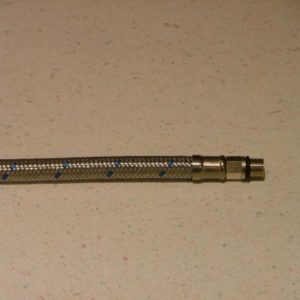

I have a new faucet to install and the included water lines have o rings at the ends instead of the regular female coupler. Included is a photo. Since one is too short, do I just get a 3/8 union and add another hose?

    Is the pictured end supposed to attach to the faucet? Or to the shutoff valve.
    What does the other end look like?
    What brand of faucet is this?

      I will check the brand. The pictured end goes into the faucet. The other end is standard 3/8 female connector.  The brand is Lenfex. Some Euro dudes.

        "The other end is standard 3/8 female connector."Hmmm. I would simple measure how much more length I needed and take the hose to the hardware store to dig up whatever would work to extend it.In theory you shouldn't need to take the hose with you, but I like to play it safe.

    It appears that end has a machine thread and not a tappered pipe thread.
    Thus the O-ring is the seal and not the threads/sealant.
    I have seen some other faucets that come with detachable feed lines. Usually the connections from them to the faucet is propritory.
    Go to the hardware store, but a good chance that you will need to keep them and put an extension on the other end.

    The o-ring end goes to the faucet. Other end should be 3/8 OD compression size.
    Your local big box carries 12" flexible hoses with male and female 3/8" OD compression sized ends to use as an extension.
    Get two of those and you are done.

      Its actually metric. Just got back from the hardware store. The 3/8 female is ok, the male end is metric. Just got 3/8 union and another short line to loop in. Should work ok until the first line poops out.Those who can make you believe in absurdities can make you commit atrocities- Voltaire
