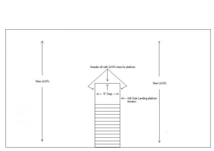

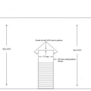

            Thanks for the idea, that's why I'm here. I called the contractor that I work with and thought it was brilliant. Anyone want to watch my 8 year old twins while I destoy their ceiling? I guess that will help me keep at it until its done. Thanks again. Ted
          11. OneofmanyBobs | Nov 08, 2003 01:40pm | #52

  5. Framer | Nov 06, 2003 11:48pm | #24
    How can I stiffen the floor without making it higher? The finished stairs wouldn't line up with deeper floor joist.
    Are the stairs the only reason why you can't go any higher?
    Do you have the height to sister 2x10's and add the 4"?
    I've done this on a couple jobs in your situation where the stairs couldn't be touched so we added the 2x10's and headered off around the stair platform keeping the existing 2x6's and just had a 4-5" step all around and never touched the stairs. It might be an option for you.
    It might not be the most practicle way of doing it but it works.
