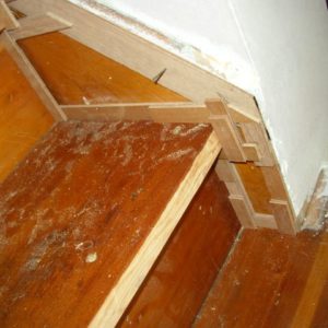

Since this has come up a few times here recently, thought I’d share my current project.  It was an old squeaky staircase.  Now it’s like a rock and looks better too.  I’d guess it cost about $200.00 in materials, but took too much time.

    I love to see quality work.  Great job.  I have some questions.  We recently added on and I am going to redo our carpeted stairs with oak.  I see that you used plywood.  Will that hold up well under children?  Their bedrooms are upstairs.  I was going to take off the 2x10 treads and put the 1 inch thick oak treads on.
    Your patterns were very interesting.  How did you fasten that small stuff together?

    1. WorkshopJon | Nov 23, 2004 12:25am | #10
       I see that you used plywood.  Will that hold up well under children? "
      Nextlevel,
      Probably not, which is why I'm aiming to put about 7 coats total of polyurethane on the treads.  Original plan was to have a carpet runner, but right now, I'll leave them be, as they turned out better than expected.
      If I had to do it all over again, I'd use 1/2" solid plained stock.  Just seemed like a PITA at the start of the project.  But for the extra few hours to mill it down, it would have been worth it in retrospect.
      and " How did you fasten that small stuff together?"
      Used an 18 gauge brad nailer/staple gun for most of it, plus lots of glue.  Nails into the studs where I could find 'um.

      1. NEXTLEVEL | Nov 23, 2004 01:53am | #12
        My set of stairs looks like yours except for the landing.  I think I will go ahead and take the 2x10 off and put 1 inch thick oak treads on.  But I do think I will put 34 oak plywood on the backs.

          Pretty work, Jon...and I think you get the prize for the farthest out of the box methods for making the parts fit. And you said you're not a pattern maker<G> Don't worry, we can fix that later!
          1. WorkshopJon | Nov 25, 2004 05:00pm | #14
            you get the prize for the farthest out of the box methods for making the parts fit"
            Bill,
            That's not how every one else does it????  I'm mentally cringing at some of the ways some folks might.
