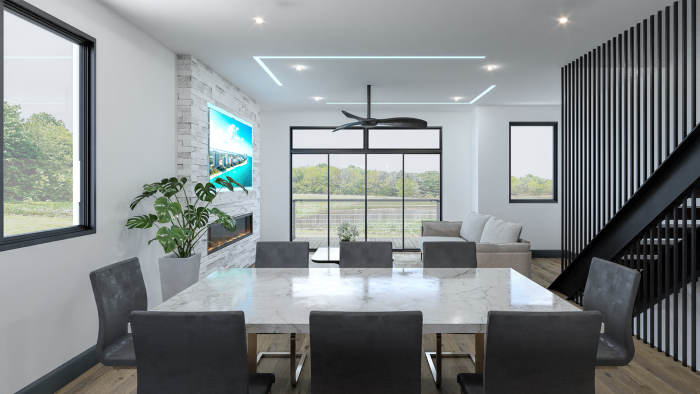

My architect and I designed a 3 story townhome. Initially, he had a standard walled-in staircase on the second level but I found a metal guy who provided this unique open staircase concept with just a metal rail bar wall. I asked the architect if this was possible without wall supports around the stairs he said they could do all kinds of spans with the floor joists.

The 3d concept photo is attached.
