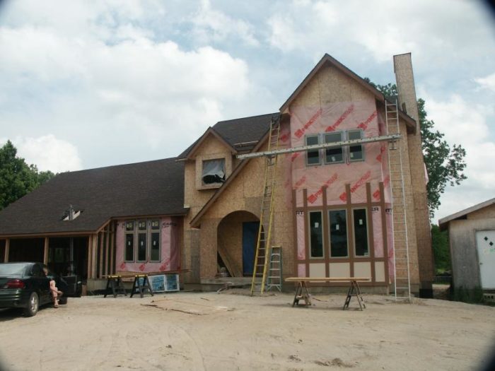

We have been building this house for 14 months. We are doing all the work ourselfs.

I shrunk it a little.

That looks to be some fine digs....

Nice looking house!
What is the building to the right? Hope that isn't a neighbor, looks like its only a couple feet away.
The building to the right is a shed. I built that over an old well pit.
Put the shed up 3 years ago.

All this picture shrinking is taking away from the nice leg shot getting out of the car. Or, are all you guys homos? And the only thing you care about is building pictures?

The legs belong to my wife <G>

Robteed, congratulations on the house. I couldn't help but notice your scaffolding and it made me very nervous. Homeowners are not required to follow OSHA guidelines but why would you subject yourself to possible injury or worse. Your ladders are not secure, there is no rope tying off your rungs, it looks like a couple of rocks have been used to level one side of the ladder, you are set up on sand, the plank is barely catching on one end and it is not secured, there are no railings, kickboards or end rails. A trip to the ER would pay for the extra it would take to do things a little safer. I'm not busting your chops, just concerned you may not be healthy enough to complete the project.
As a long time builder, that set up would have been like a super highway to us many years ago. Today it is a recipe for disaster and for employers, illegal. There is another post on this site. Someone's wife jumped down off a 4' scaffolding and hurt her knee seriously. A fall from your height, especially if you land on those horses won't be fun. I also hope those pretty feet in the flip flops are going home, not to the job. Sorry to be wagging my finger but it's only for your good.
The ladders were not set on rocks, They are indeed set on sand. Its very
compacted sand, the ladders are set at angles into the knotched overhangs above. I take safety very serious. I determined that there
was no way the ladders could move to the sides, or out for that matter.
Its true I dont have railings on my pic or any safety ends. I am the only person going up there and I wouldnt go if I thought It wasnt safe.
Thank you for your concern though.
I would be more concerned about the ladders leaning up against the rake fascia.
Jon Blakemore
The whole set up could be improved with just tying the plank. Those are the type many of us have accidentaly walked off a time or two.
