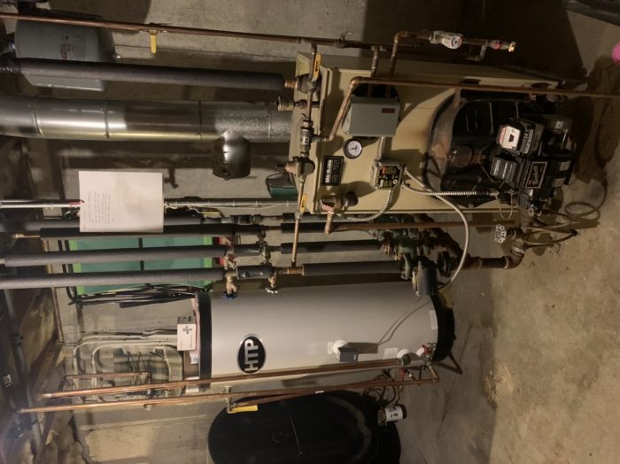

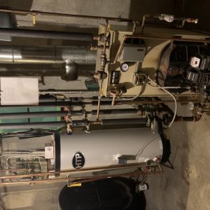

We have a boiler with a booster and it seems to be running Waymore just recently. I was reading posts between Jako17 and BitbyBit and the recommendation by Jako17 was to shut the boiler off for the summer. Is there somewhere I can at least turn it down or something?  I would be glad to shut it off except our boiler heats our water. We have a well McLain gold boiler, So if anyone could be helpful I would appreciate it.
One last thing, could this be killing my electricbill? If this just keeps running? Electric
bill is over $400 every month. It used to be over $400 when all five of our children lived with us and they had 15 friends over all the time. We also had a hot tub and a swimming pool running. It’s the same now, the electric bill with four people living here, no hot tub And no pool.  I have added photos of my boiler. This might help with some of the responses.

    Your W-M Gold "water heater" is a storage tank, indirectly fired. This means the water is heated by the boiler - a separate unit. The boiler is what is firing up too often , correct?
    Is the boiler electric, oil or gas fed/ powered? If oil or gas, the $400 electric bill is caused by something else. I don't think a recirculating pump will use $400 of electricity/ month, but as an experiment, you can disable it, but then you'll have to wait a minute or so to get hot water at the tap if it hasn't been recently used.

          We recently had someone add a new water tank because we could never have a hot shower and our water pressure was absolutely horrible. I added a few photos so you could see my setup.

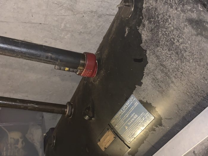

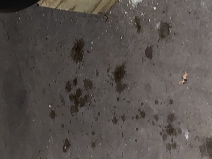

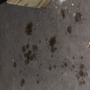

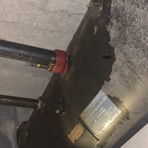

      WOW! Great idea. I was wondering if some of the air conditioners are just old. Probably why I was concerned about the boiler was because I didn’t think it was running too much. I did also notice some oil on top of the oil tank. Is that normal? I do see a bit of corrosion to on my boiler and the booster

    if the boiler runs more than it used to, it is likely that the folks who installed the new indirect water heater set it up to do so.
