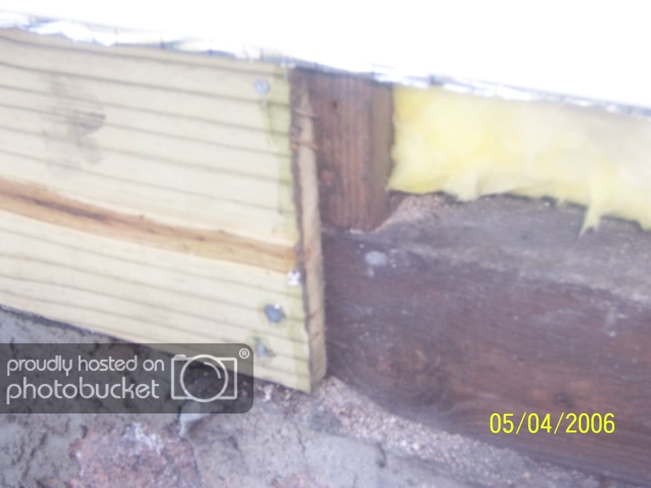

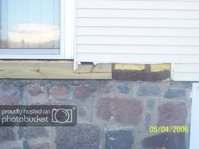

How would I install a 2×8 ledger on my house?

  1. Danno | May 06, 2006 04:08pm | #1
    I'll reply as sort of a "bump"--I know you're not supposed to use lag screws (supposed to use through bolts), but with what appears to be a 4x4 sill, I was wondering why you couldn't screw the ledger to that. Have to flash everything to keep water out, of course. Another thought that people have mentioned alot is to forget the ledger and put another row of columns close to the house and cantilever the deck toward the house. Then there are no worries about water getting into the house.
  2. Jer | May 06, 2006 04:16pm | #2
    Through bolts if you can. If not, long lags two of them set within a couple of inches of each edge of the ledger board every 16". May be overkill but there are nightmare stories of deck ledger boards not being properly installed, then the giant cocktail party one night and....well, you know the rest.
    Other than that, it looks fairly run of the mill stuff there. Fill in where you need to and make sure that the ledger is properly flashed. Some builders like to not use a ledger board but rather dig separate footings right next to the fondation and butt the new deck up to the house making the deck separate from the house so there's less chance of water leaks. Seems like a lot more work, but it's not a bad idea.
    1. TheDudeAbides | May 06, 2006 10:42pm | #3
      I was thinking of through bolting the bottom (through the 4x6) and then lagging through the 2x4's with 1/2" x 4 lag screws... Can you mix bolts and lag screws?
      1. Jer | May 06, 2006 11:42pm | #4
        Where you can't put through bolts, I would lag 'em. Sounds like a plan.
