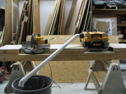

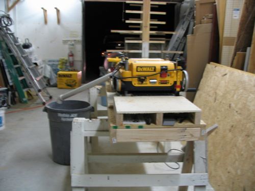

I bought one a few weeks ago or so and love it.
I've used both speeds, altough I haven't noticed much differnce in cut quality between the fast and slow feed rate.
Like Doug said it's a heavy SOB, I wouldn't want to bring it up and down stairs.
Two other minor down sides I've found, the chip ejector works so well it sprays chips every where, the fan assisted ejection has some serious power, not really a negative though. The PVC pipe I have attached the outfeed at least keeps the chips heading to the ground, don't let the garbage can fool you though, none of them end up staying in there.
The other downside I found was the short table, and no standard outfeed extensions, you can buy them for an extra 50 or so bucks.
Instead of buying the extenstion wings I build a table that holds the planer and my 10" chop saw. For the same money the extensions would have cost in materials and a few hours it works well.
And I usually hate dewalt tools, but it appears they got it right on this one.
Does your setup cure snipe?
Thx
so far snipe hasn't been a problem with the outfeed table.
For your trash can problem you might try a piece of fiberglass screen and a couple of bungees.
