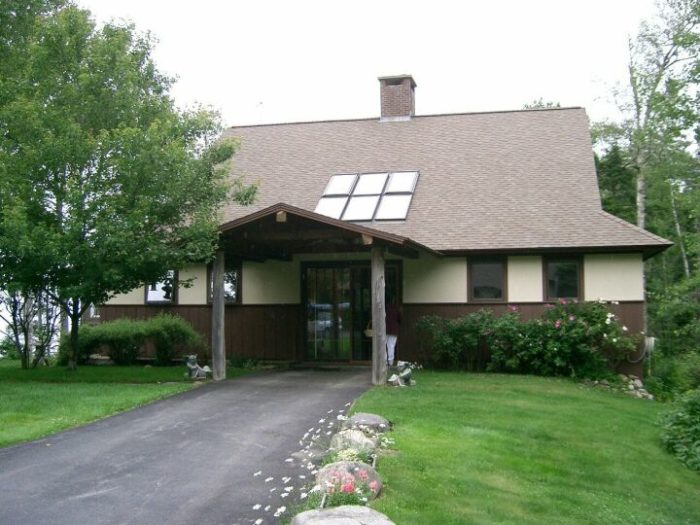

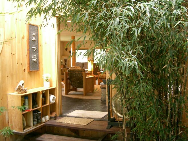

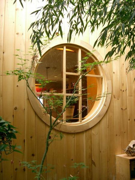

Here is a shot where I built one as part of a semi-jap style house. It was the entry vestibule and shoe removal area. Lots of venting skylights in the roof, and the whole thing was located at about 4' lower elevation than the main floor to keep water down below where there would not be flooding problems
Sweet, thanks. Yeah we were thinking of making it part of one of the entrances or a sitting area shared between the bedrooms.--Carlos
