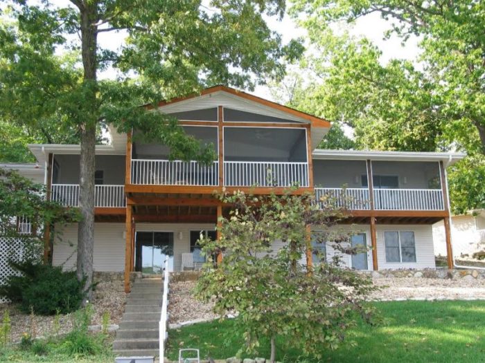

Nice place!
Edited 6/26/2008 11:36 am ET by USAnigel
Thanks. I gutted it in and out when the existing unit was installed. Well insulated. Growing old is inevitable, Growing up is optional.

The pic is the east side, right? You get a fair amount of morning sun it looks like. What is going on ... on the south side ... windows? Shading?
