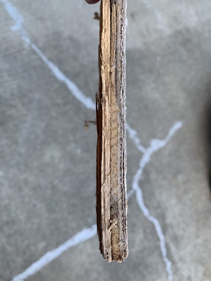

A contractor flaked on a customer we worked with in the past and I’m trying to see what I can do to help her out. This is a balcony that has what looks like an anti-slip coating on it, I just don’t know what was used. I attached a picture of the other deck that looks exactly like the old one. The repairs were done right they just didn’t paint the top and give it a descent cosmetic appearance?
Any suggestions be greatly appreciated.
Pictures attached of the old material and the other deck she wants it to look like.
Might be fiberglass. Where are you located? Fiberglass is often used in coastal locations
I peeled back the piece and it certainly looks like fiberglass strands. Yes I’m in a coastal area - San Francisco Bay.
