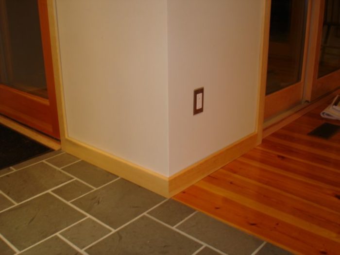

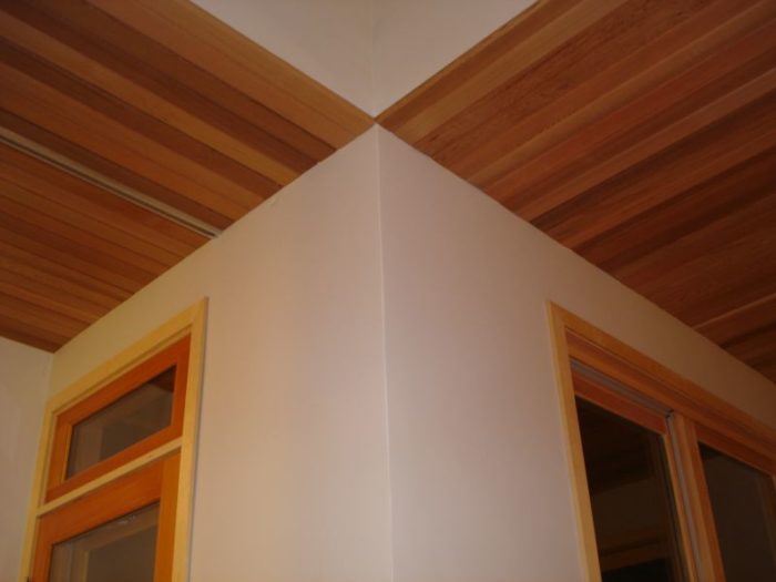

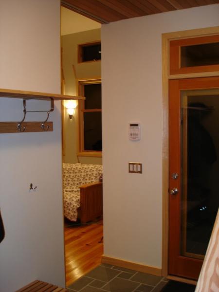

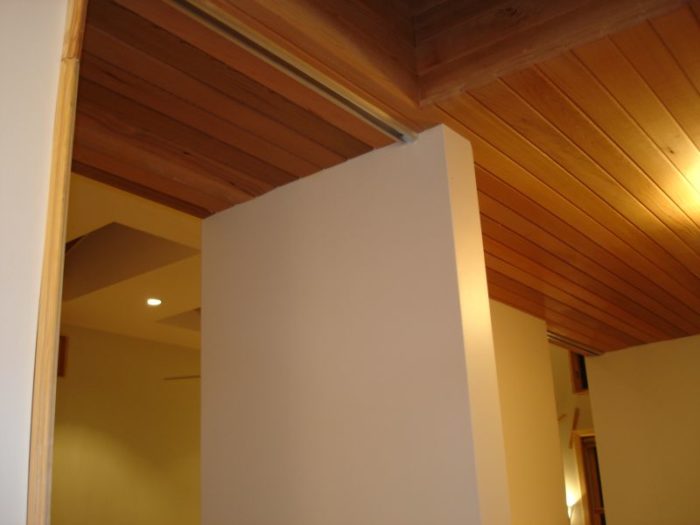

Here are a couple of pics, took forever to upload for some reason.True my architectural aesthetics are modern but probably more mid-century modern, but I'm a carpenter too, so this house is full of wood: heart pine, fir, cedar, mahogany, poplar and birch (some oak furniture) and stainless steel. It has no plastic, except for FG (Marvin Integrity) windows. The pockets are tall doors because the openings are full height separating a 12' high living/kitchen area from a 9' high entrance corridor.

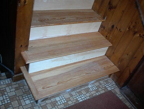

That makes it a WHOLE new perspective - thousand words tothe picture and all that...This is really more of a sliding wall panel than a pocket door!But given your prodigious use of wood, it seems like a piece of heart pine or fir routed as a slot to act like a jamb with stops would be right at home there. I definitely would not slit the baseboard bare as you have it there. BTW, Heart pine! You're all right in my book!Here is a shot i took today to update a customer on progressMake that two shots plus one of stair treadsI love heart pine. My own living room and dining is just like yours

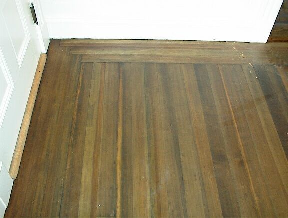

floor finish - remodel jobBut I've done a few similar to that on wainscot

Tgny: One thought, for the pictures Middle pocket, and front pocket. The middle pocket looks like you could wrap the end of the wall with 3/4" jamb kind of like a column on the end wall 3 sides 1x4 or 1x6. Then the front pocket is at the corner a full height jamb would not look bad with the base butting into the jamb rather than the 45 corner. The house looks a bit like a craftsmen so the clean square 1x material may look fine. I don't think I would notch the base.
Same thinking
That was my original intention, but when it all came together, I reconsidered it, guess I'm going to consider it again. The problem is the rear pocket will just clear the back door casing, so it won't work there.
