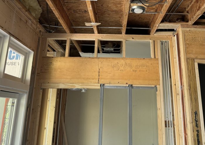

I went back and looked at the pictures of the framing of the opening. It looks like the header consists of two 2x12s connected right above the metal frame of the pocket door.
Would love to get thoughts – weather, framing or combination? Thoughts on how to fix it? Should I shave the wood framing to make the gap larger or will it just bow even more?

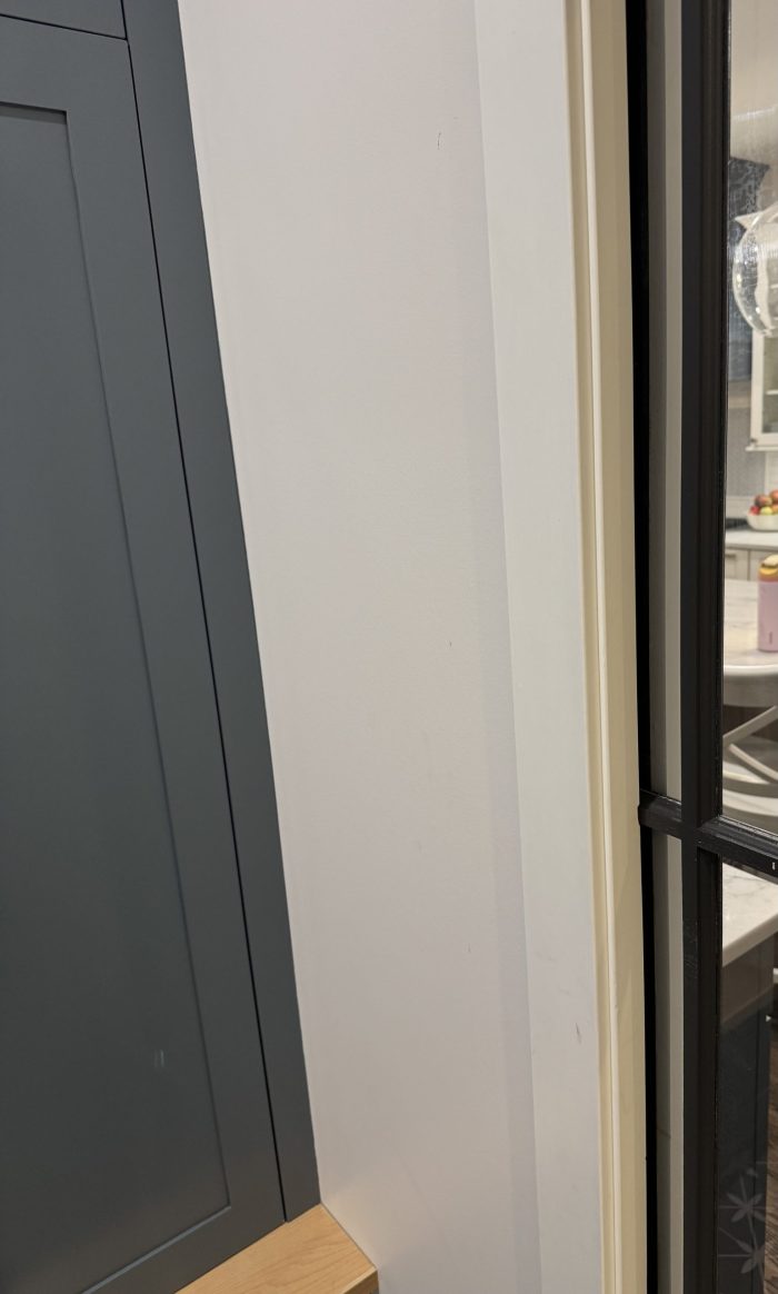

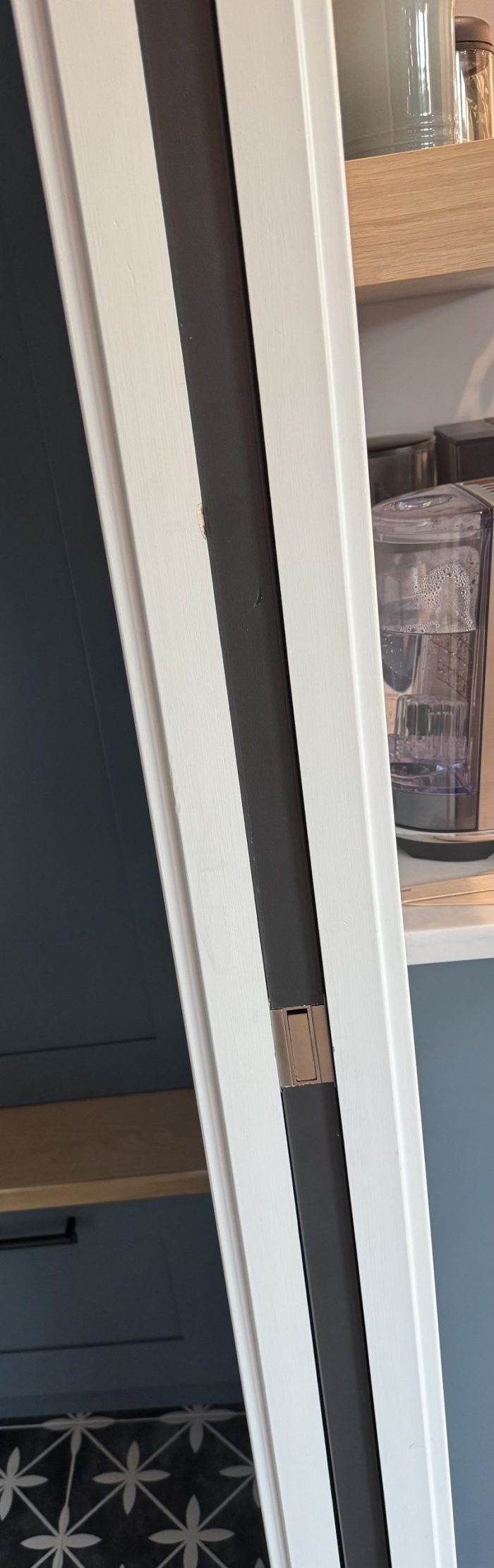

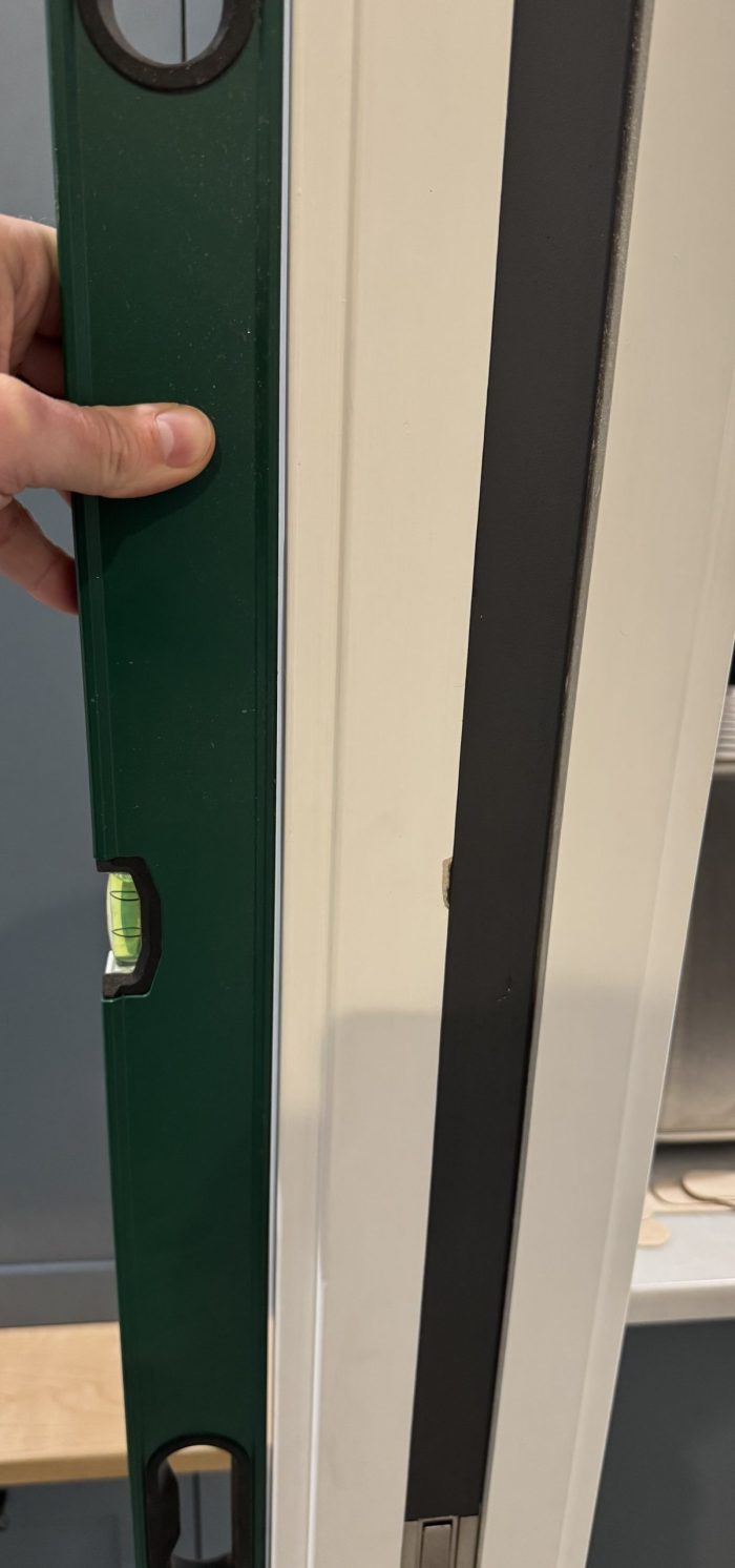

      -I only had a 4’ level handy but the right side of the jamb is plumb (1/16” off). The left side is where I lose it. See pic. The level is plumb but you can see how the trim bows in toward the door.
      -I checked the drywall on the same wall. See 2nd pic. At the cabinet, the wall is plumb but 20” over right before the trim, it’s also bowed.
      I was thinking I would remove the jamb trim and widen the opening. However, since the jamb can’t bow in any further as it’s up against the door, will the jamb just bow further after I widen it? It seems odd that only one side of the jamb would be bowed so part of me is hoping that what they installed was warped to begin with and replacing / widening it would solve it.
