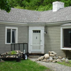

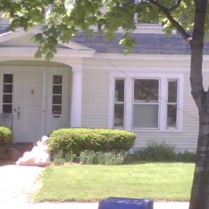

Hey All, I am new hear. From the seacoast of NH, I am working on my current project and wanted to get some input on portico style. I have removed the old stone stairs, rotted sills etc. Replaced the door, and built the porch. I will be layingthe IPE with concealed fasteners(of course) this week. I am using 2 “square recessed panel” posts(8×8) that are structural. I am hoping you all can give me some input on roof style/finishing touches. All trim is Azek. I guess I am wondering about 3 options, a shallow barrel in the ceiling, a deep barrel(both of these would extend through the gable and be open) or lastly a small return (hip acrooss the front say 2 course of shingles or so) ceiling will be finshed in a natural wood(TBD) door is Mahogany. One of the main goals in the project was to raise the roof over the door to eliminate the ugly (odd) slope over the door( a ice dam waiting to happen). These are my 3 basic ideas, any other options would be appreciatted. Deck is 66″ x 60″. I have attached a couple of pics for your reference. The garage doorways are arched if that is a consideration. Sorry for the long winded first post. Pitch will be 9/12. Thank you all in advance.

    1. Piffin | May 28, 2009 01:49pm | #2
      I did see it, and it is an interesting challenge. I am letting it stew in my subconscious to see what happens first.This guy is doing some fine work and patiently getting things right, so he deserves consideration.
  2. ANDYSZ2 | May 28, 2009 02:11pm | #3
    I would consider doing the overhang in a curve from wall to wall past the stairs with an eye brow type roof to keep the water from draining on the path up to the stairs.

      1. Hudson Valley Carpenter | May 28, 2009 06:15pm | #5
        I mean like I would visit the Conehead architect who dreamed up that entry and pull out his eyebrows. ;-)
        Edited 5/28/2009 11:22 am by Hudson Valley Carpenter
        1. Piffin | May 28, 2009 08:41pm | #7
          My thoughts weren't quite that harsh, but I did have a WTF moment.
        2. dogville | May 29, 2009 04:21am | #12
          Agreed, It has driven me nuts since I purchased the home 1 year ago. I just finished retooling the entire interior(most of it) and am moving outside. I have always felt it could be a very appealing entry if altered. We will be taking the rade down 3-4" to improve drainage issues, putting in a new paver walkway. Re-roofing the house with Landmark TL's and re-trimming with AZEKS with concealed facia vents(there are only gable vents currently...

      I had thought about this too, and felt it would interfere with the windows, the house is approx 8/12, I am bumping it up to 9/12 to get out of the flat spot. As it is fairly narrow, I am concerned about going to the ridge, which I agree would be the ideal solution. I am re-roofing the house next, so I will I/W that area etc. Thinking about open valleys w/copper.

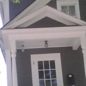

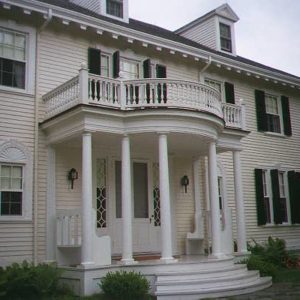

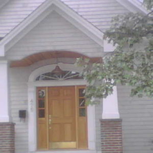

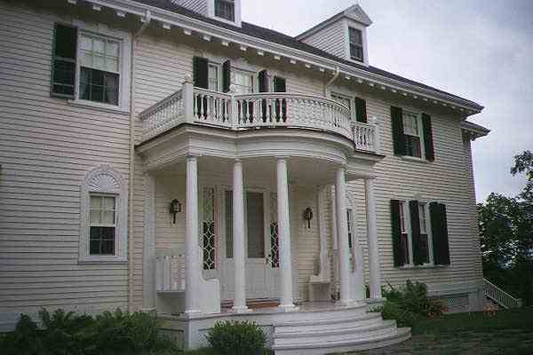

  6. dogville | May 29, 2009 05:06am | #15
    Some pics of styles I think would work with variation/modification-
    #218- Like the returns with soft barrel, my post would strengthen the look
    #216- the rounded trim with gable return would tie various elements of the house together.
    #212-Return across Gable is classic
    #228 has simple elegance. soft barrel feature, gable maybe to plain...
    Ok, throw it at me......
    Edited 5/28/2009 10:07 pm ET by dogville

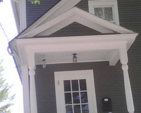

    1. dogville | May 29, 2009 05:13am | #16
      Ok, last one and I am out like a light...
      See post #104955.1 By Tim Uhl??
      Also, in the same vibe of my thoughts.
    2. Piffin | May 29, 2009 01:21pm | #17
      In the end it is what you like best. I like a barrel but don't think it fits your house there. The second photo with the full return across the pediment is my choice.What I had set out to do was to draw up what you have in each of a couple different styles to help you see it for comparison, but I got word last evening that Mom is having surgery today for colon cancer so I am temporarily out of time and of focus.Maybe later
      1. dogville | May 29, 2009 04:00pm | #19
        Piffin, thank you for your consideration. My best to you and your family as you move forward in this challenging time. Best wishes.

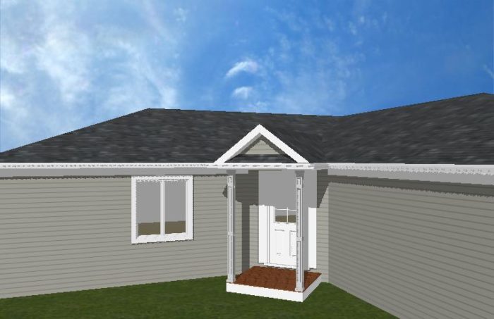

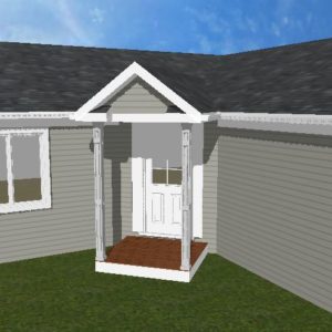

          2. Piffin | May 29, 2009 11:14pm | #25
            Now that I've been playing with it, the 9/12 is good.I had guessed a 5 or 6 pitch for the house.These two drawn are with 9/12 on the dormer and 5/12 on the roof with a 12' run on the main roof.Gotta go figure out how to draw a barrel open end now tho....
          3. Piffin | May 29, 2009 11:34pm | #26
            which comes out something like this
          4. Hudson Valley Carpenter | May 30, 2009 12:14am | #27
            While you're at it, how about cranking out a bigger one, with the ridges joining.
            The impression I'm getting from these three drawings you've presented is of a back door, not a main entrance.
          5. Piffin | May 30, 2009 12:22am | #28
            back door was my first impression from his photo.Since his deck is already built, i'm trying to work with what he has, so far.You are right, I should kick over the stanchion and go feed on clover with this one. See what appears...but I have some other things going on right now....
          6. Piffin | May 30, 2009 12:26am | #29
            given my druthers, I'd probably stick something like this into that corner so the flank faces of the palladian roof flow to t he house wings, use a nearly flat roof, and not worry about the valley. A good copper man or an EPDM roof done right would handle things.
          7. Hudson Valley Carpenter | May 30, 2009 12:41am | #30
            Ahh, so now you wanna do it Gone with the Wind style.
            From the Conehead version to Rhett Butler, in one swell foop. ;-)
            Edited 5/29/2009 6:00 pm by Hudson Valley Carpenter

    1. Piffin | May 30, 2009 06:18pm | #39
      Something along this line, you say?
      1. Hudson Valley Carpenter | May 30, 2009 07:10pm | #40
        If we're voting, that one gets my X.  Looks good, quick to build and it leaves room for a small foyer or a hall closet.  And, who knows, that porch might actually be useful, at least a good place to park a couple of bikes, out of the weather.  All in all, best value.
      2. runnerguy | May 30, 2009 08:39pm | #41
        Looks pretty good to me. Probably beyond the scope of this thread but if the owner cleans up a few minor details like integrating the bay window roof with the main roof and some visually heavier columns with well defined rail/picket details, he's there.
        Nice job Piff!

            Maybe I missed it, but did you answer the question what is the actual run of that 9/12 pitch? I enjoy diddling with this when I have time, but don't feel like wasting time either with assumed values.Also what is the overhang soffit?
          17. dogville | Jun 04, 2009 02:30am | #62
            I think i will answer your question(hopefully) there is no soffit on the house a build up of 1x10, 1x6 and 1x2 under the drip(gutters hange and cover most of the 1x6). The house is 8/12 run is around 9 1/2 Ft. Deck is 66"(same as widest point of the cricket), rise to peak is approx 25", run I am not sure how to calculate run on Portico(is that sad or what?) 8" posts are set to be centered on 48"(so they will span 44-52" out of 60") meaning approx. 8" extension beyond post to front edge of deck. decking is all pre-cut, biscuit cut, penofined and ready to lay in the next day or so.....
          18. Piffin | Jun 04, 2009 12:42pm | #64
            I gotta go back to look at the picture again, but I must be missing something here. 25" rise over a 9'6" run works out to about a 3/12 pitch is all, and I thought I saw some sort of soffit projection - maybe that was just optical illusion and gutter.
          19. Piffin | Jun 04, 2009 12:57pm | #66
            I see now - the freize board on the wall is the 1x10 and the gutter is making the shadow I see.The rise of the small roof plane over the door is what might be rising about 25"
          20. dogville | Jun 04, 2009 03:38pm | #67
            I think closer to 20-22, as the 8/12 just came to the top of it and the 9/12 got me out of the cricket, there was one course of shingle exposure difference between the 8/12 and 9/12 as to where the ridge will land. I will try to load a couple more pics so that you can get a better overall view of the house and how it sets. I really think the Portico will look just fine and that you will agree once you see the pics....
          21. dogville | Jun 04, 2009 04:26pm | #68
            Piffin here are a couple of pics with a wider view of the house, let me know if I have reduced them to much.... Thanks again...
          22. Hudson Valley Carpenter | Jun 04, 2009 05:23pm | #69
            Referring to photo 072, Piffin's porch concept would fit very nicely, particularly if the arched garage door openings could be repeated between the supporting columns, both in front and on the end.
          23. User avater
            aimless | Jun 04, 2009 07:41pm | #70
            What a gorgeous piece of property!
            You have your mind set on a portico, which I would too if I'd already made the foundation for it. If it were me in that setting I'd shoot for an Arts and Crafts feel with stone or clinker brick at the base of squared columns  - sorry I don't know the architectural terms.  I'd echo the curve of the garage door in the framing, something like this:
            http://architecture.about.com/od/artsandcrafts/ig/Craftsman-Houses/craftsman1070053.htm
            Of course you are scaling it way down based on the size of the foundation you've laid for the steps.

          29. Piffin | Jun 07, 2009 03:26pm | #76
            This should show more accurate to pitch and dimensions you gave.I played with a couple other ideas that ended up looking bad.The return all along the front helps with that horizontal line that Mike Maines mentioned. The shorter hip return looks too formal for this house to me.
          30. dogville | Jun 07, 2009 05:06pm | #78
            Piffin, So what do you think about a rounded facia(like the garage) to tie it together? Do you think this is to narrow for a barrel(soft one, not a very deep one)?
            Thanks this really is helping us....
          31. Piffin | Jun 07, 2009 05:20pm | #79
            The barrel just doesn't do anything for me on this house. I don't see anything historic about thsoe garage doors either.
