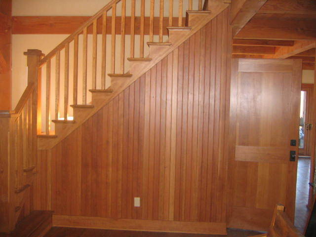

My place is post and beam....if I had a water problem......sanding would be the last option (unless of course it was just a small area)
My beams are watco finished with a wee bit of coloring ..... a lot would depend on what kind of finish you had and the style of your place....
Know that sanding through the patina will leave a pretty good mark in the beam.......I would probably first try some sort of blending using the original finish and adding some pure color to make it blend and work .............be an artist.......
