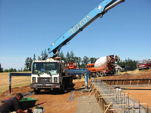

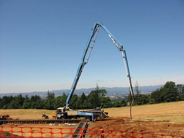

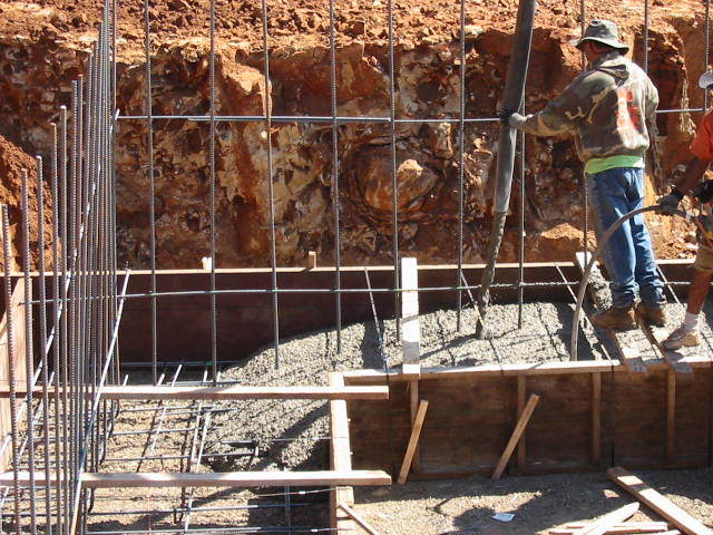

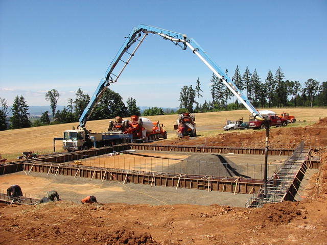

Some shots of 54 yds. being poured.
Late start, trucks had a 45 minute drive , one got lost in transit.
Wonderful time was had by all!

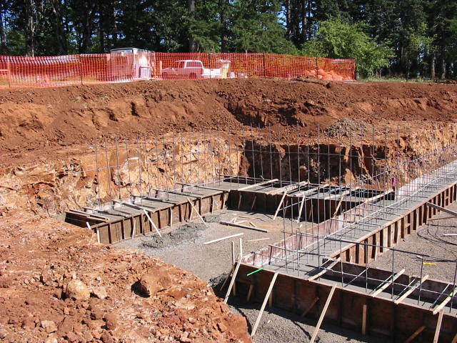

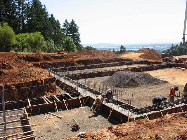

i live a shelterd life,maybe someone around here pours a 2' wide footing,but wow,those are some big az footings,what are they 4' wide? whats going on top of them? nice looking job on them. larry

20'tall 8" tall ICF walls, plus two of the footings carry a 54'roof span and second floor room. Also one footing is for a 10' tall retaining wall.
