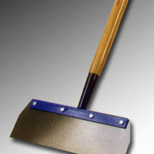

    Floor scraper
    I'd try a floor scraper. It should get under the flooring and cut the glue. Unless the flooring wants to delaminate it should work. If the flooring does want to delaminate, nothing will work.
