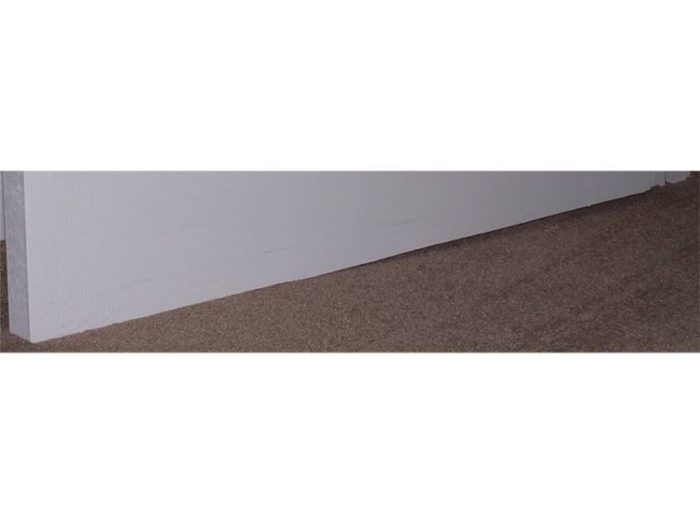

2) A door that is attached to a wall that also slants, so that the door digs into the rug when opened (DoorTippingIntoRug.jpg).  Again, the level says it is just barely within tolerance, with the bubble’s edge right on a tolerance line.
3) A handicapped-accessible bathroom wall that is not square along the bottom (the top IS square).  Its angle is made noticable because the linoleum’s square tiling pattern acts like a ruler for measuring different lengths (BathroomWallSlantsOut.jpg).
Originally, the door wouldn’t close either because the bottom of the door stuck out about a half-inch when the top part was closed, but the contractor took care of this by adjusting the strip of wood in the doorframe that acts as a jam.

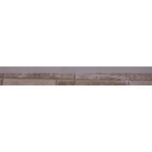

4) In the master bath, there are cracks in the grouting that run roughly parallel to the grout lines and appear to be the result of shrinkage, but might have been caused by something else (CracksInGrout.jpg).  These cracks are widespread.

    The door that rubs the floor should have been cut off and still can be,  whoever hung it was trying to get in and get out.  Actually needs to be rehung as well,  if it's not perfect then it needs to be.  Thats what rough openings are for.  How are the reveals on the door when it's shut?
    The grout if it's new,  needs to be taken out and redone.  The installer should do that as I am sure he has given some sort of warranty to the GC.
    The tile is another issue,  can you put up a bigger picture?  Is this in the new or old part of the home?  Is the tub level?  I cut the bottom row of tile to fit the tub,  looks like your guys did it at the ceiling.

      "The door that rubs the floor should have been cut off and still can be"
      -- Thank you for confirming this.  The door seems to stay in place when you swing it to a particular spot, so once the bottom of the door is planed, we should be OK and not have to do anything to the wall itself.  It seems plumb enough.
      "The grout if it's new,  needs to be taken out and redone"
      -- Good to know.  As for the tile, it appears to be OK; it was just a bad photo due to inadequate lighting when the shot was taken.

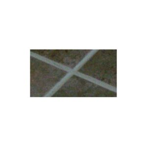

      Attached are two photos that give a better view of the grouting job.  One shows cracks and a plain-old rough finish, and the other shows that the grout is actually missing in spots along the wall.
      If I had done this myself, I would have taken off the wall base before putting in the tile and grout so that the tile pattern would disappear under it rather than get broken up by a bad grout line where the tile was roughly cut.
      Could you confirm that you think it's reasonable for me to ask the contracter to go back and re-do the tiles along the wall that are affected this way, in addition to the grout?  Thank you!

        Same with the tile and grout,  it looks slapped together to me.  I am only seeing small pictures of what is a big picture but from what I see the finish is not acceptable.
        The trim should have been taken off in the last picture,  that joint is going to crack like a SOB when it gets the urge.  Wood moves at a different rate than grout and that seam is always to be ugly with the cracking it's going to do.

            Make sure any new doors don't rub on the floor,  they can be cut down and rehung under 10 minutes a piece.  They should close easily and not rub on any part of the jamb or floor.  They might have set the doors before the carpet and didn't shim them up.  Thats why they are rubbing now.

    Grout should not have any cracking. That indicates that the substrate is moving somehow, or that the grout was mixed too wet and shrunk, or somehow else mixed wrong. Do not let them just caulk to hide the crack.
