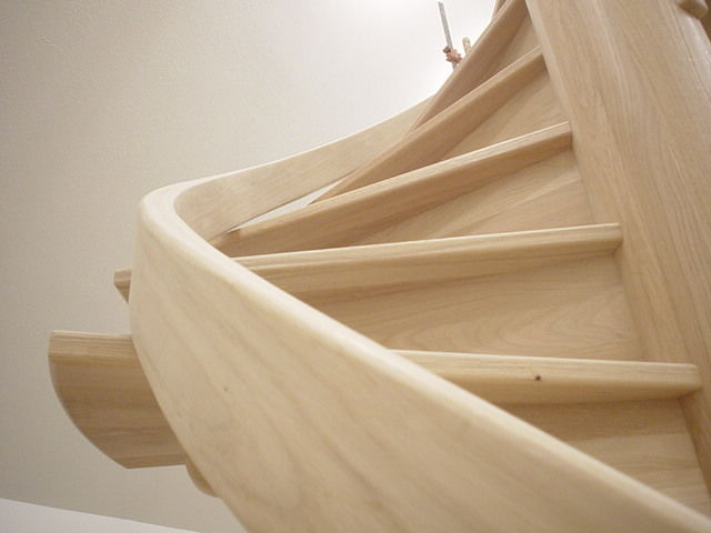

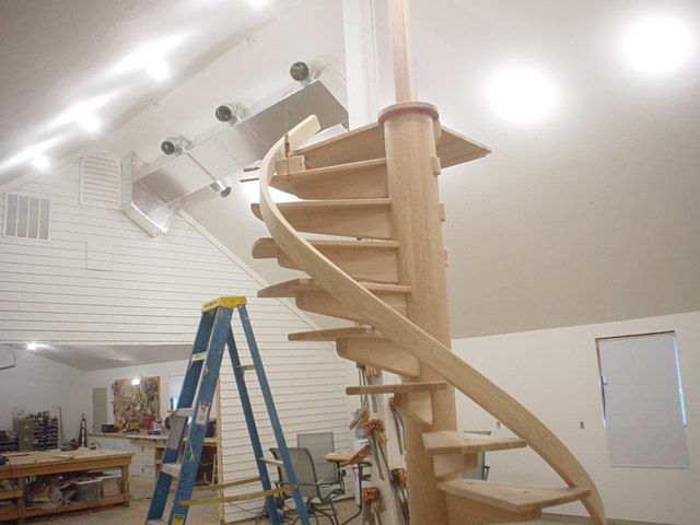

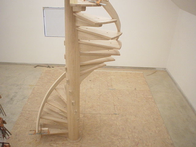

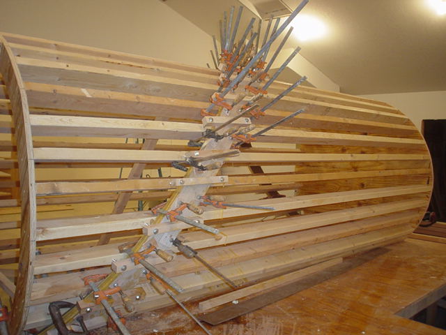

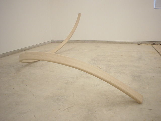

Here are some pictures of a curved rail hatching out for the white oak spiral I am building. I glued it up last Monday and let it sit while I was on vacation.

Stan, are you the guy who drives up the price of clamps on Ebay?

How many laminations in that rail? Looks great.

Boy, that looks so pleasantly natural...purty<G>Question: does that rail have to meet code? Here, we have a minimum 1 1/4" circular cross-section, up to 2 5/8" max. That's for handgrip part...I have to get a variance for something 2 x 4ish on edge, and that depends on the inspector. You are filling up my stair folder, all by yourself...LOL Don't worry, we can fix that later!
bucksnort...Thanks.....This stairway will not be under close scrutiny...but the handrail height...baluster spacing...tread depth...ect. will all meet code if it had to.
