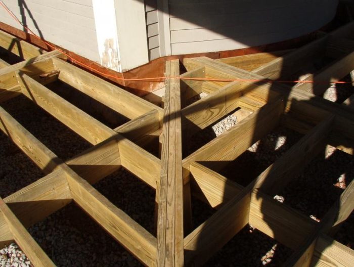

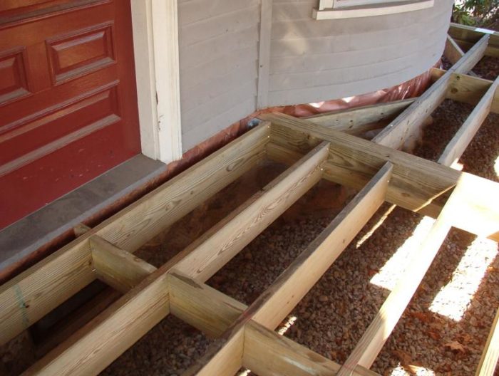

I’m in the final stages of reconstructing a 100 year old porch on my house in MA. The old deck & framing is gone, and the new framing is almost done (2x10PT, 16OC, joists parallel to house). I’ve made my final decision on the decking and want to give everyone a chance to straighten me out if I’m headed in the wrong direction. I’ve studied this to death and finally overcome my analysis paralysis, so this is it:
1. 1X4 Ipe, running perpendicular to house (8-10′ lengths), face screwed / countersunk with glue/sawdust filler (John Hyatts method). 2. No glue (I think the screws will hold it – 2 per joist, every 16″ – if I was using x6, I would probably glue – but otherwise, I’ll just get glue everywhere and make a mess, so I’m skipping it) Any further advise or comments (from anyone?) That’s it – away we go … I hope to have framing completely done this weekend, then wood delivered Monday and let it acclimate a week (under cover) before installation. Wish me luck – I’ll post pix when it’s done … thanks all … Bill. |

There's nothing underneath that I'm worried about - PT2x10s sitting on PT6x6 posts sitting on 8" sauna tubes, 4' deep. Ledger on house is flashed & counterflashed, and with a 8-10' overhang, I'm not going to see all that much water under there anyhow. Skirt around the deck will be some kind of lattice work, applied at the end - probably PT if I think I can get it to take a white stain, with fascia boards made of that white composite stuff (Avex, or something like that).

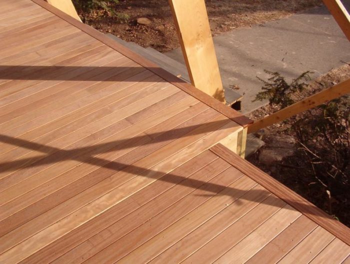

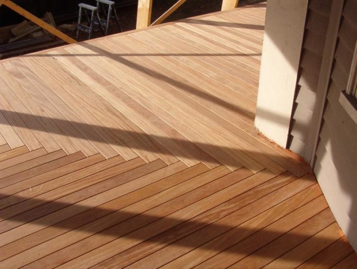

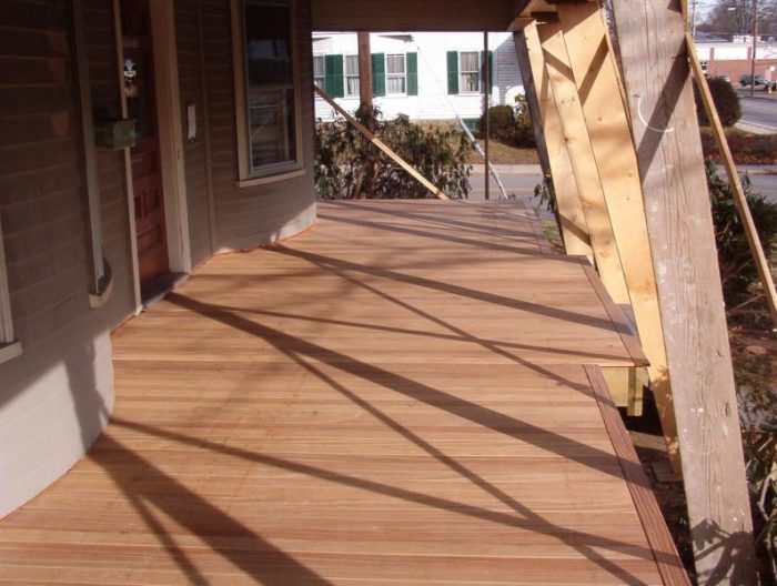

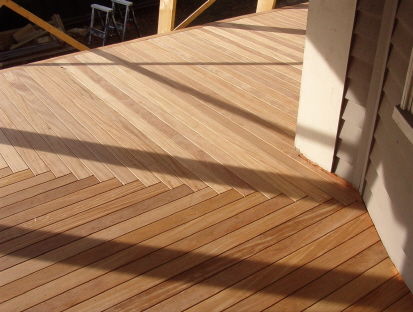

Well, it's almost done & I couldn't be happier! Working with Ipe has been almost a religious experience - it's hard to describe how spectacular that wood is. I'll attempt to attach a couple photos below.
So .. I used 4/4 1x4, pre-drilled with 1/8 clear hole, with a counter sink bit - this created a shallow/wider hole than i really liked, but with some practice (and I got PLENTY of practice), I was able to control the size of the counter sink. I made a bunch of rookie mistakes, but I think all are recoverable (the worst was shearing off a lot of screws in their holes, until i figured out that the pilot hole wasn't all the way through the Ipe) I put two in the ends, then alternated sides, one per joist. That worked out well - assuming nothing moves in the next 6 months, I should be fine. There are a couple spots where the flooring doesn't lay perfectly flat - in the areas where I went over a beam, despite the use of a power planer to get everything in a plane, you can see a little hump - I think I'll unscrew those and re-plane underneath to get it right.
I started using my elec drill to screw them in - nearly impossible to control the depth - CSNOW took pity and brought over a cordless impact driver (thanks neighbor!) ... what a difference! As soon as I got that, the installation went really well.
I herring-boned the corner, using a nice carbide round-over bit to get the ends of the boards to match the edges ... worked perfectly - hope that comes out in the pix. I decided to skip the miter corners (thanks for that advice!), and just used "breadboard" ends. Looks perfect.
Next step - columns, then a long, scotch-assisted winter's nap. In the spring, I'll think about sealing it, railings, skirt, ceiling, roof, etc. ...

Thanks for the suggestion Doug ... here are the photos, resized .... Bill.
